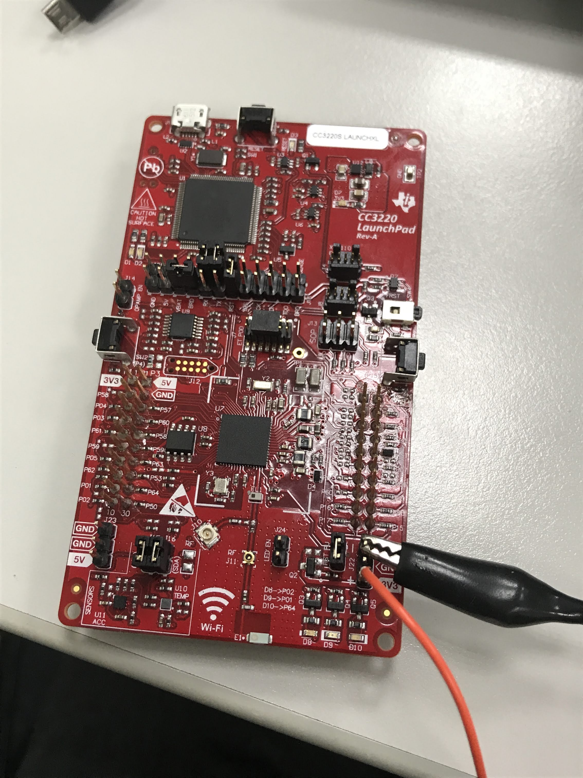

1. How to configure the jumper?   - I try to configure the jumper according to the Battery Powering Only the CC3220 and U8 (Onboard Serial Flash) section of the CC3220 Development Kit Hardware User's Guide. But it is not work, In my tests, I configured the jumper to work as follows picture.
2. Why is the average power consumption 17mA? Is that because of the AP router?(I am using the iPhone as an AP router )
  • Hi Jack,
    Can you remove all of the jumpers besides RST_PU (J9)? The jumper configuration connecting VBAT and BRD is only for battery power if you would like to power the entire board (this section is above).
    Did you remove R141 as well?
    Sarah
  • Hi Sarah,
    If the BRD is powered off, the CC3220 will not be able to connect to the AP. I want to test the power consumption of the CC3220 and flash, so I don't need the entire board, but I don't know how to remove it and it works fine.
    Please note that R141 has been removed.
    Provide the uniflash zip file as attached and it is the same with TIDC-01005-SW . Can you help check if this is correct.

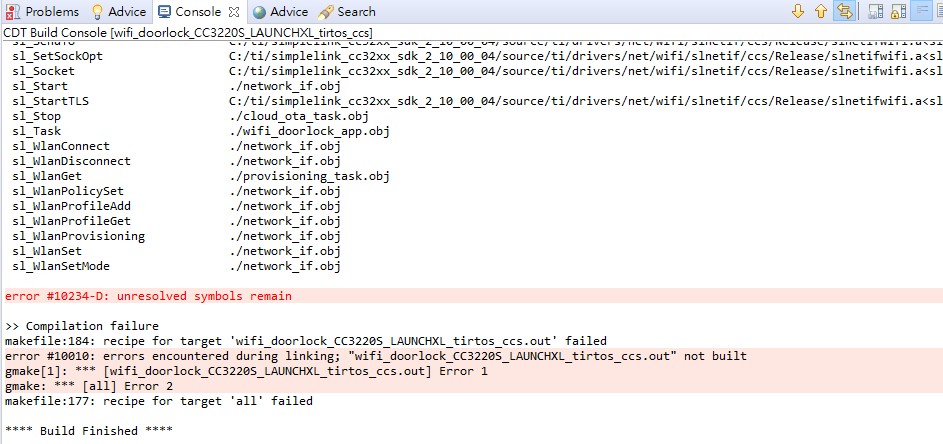

    I can import the project after checking the list of "Installed Products" as your last suggestion. But when I compile the project, I still get an error message.
    Error message: "Please define your personal cloud account token in OTA_VENDOR_TOKEN above"
    I tried to disable OTA by changing the definition "#define OTA(0)" in wifi_doorlock_app.h, but I still get the same error message.
    If I don't need the OTA function now and don't have OTA_VENDOR_TOKEN, how do I disable OTA?

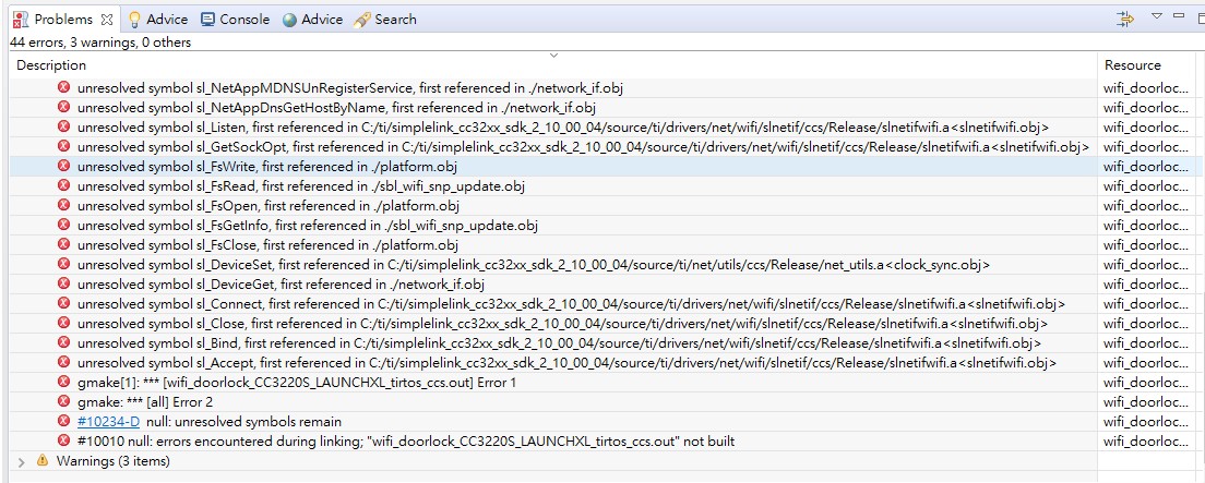

  • Hi Ben,
    Update status
    I am trying to create a new CCS workspace and import the "wifi_doorlock" project again.
    Changing the setting to
    #define OTA                 (0)  // disable OTA
    #define SENSORS             (0) // disable Sensors
    and I got error message as follow, Please help me check what I missed.
  • Hi Jack,
    By default, the door lock project expects the SimpleLink host driver library project ('simplelink' in list of projects that can be imported from SDK) to exist in the same workspace as the main application. If a compiled version of this library (simplelink.a) is not being linked to the project, that could explain the unresolved symbols.
    Try importing the library and making sure the doorlock application successfully links to it, then build again.
    Ben M
