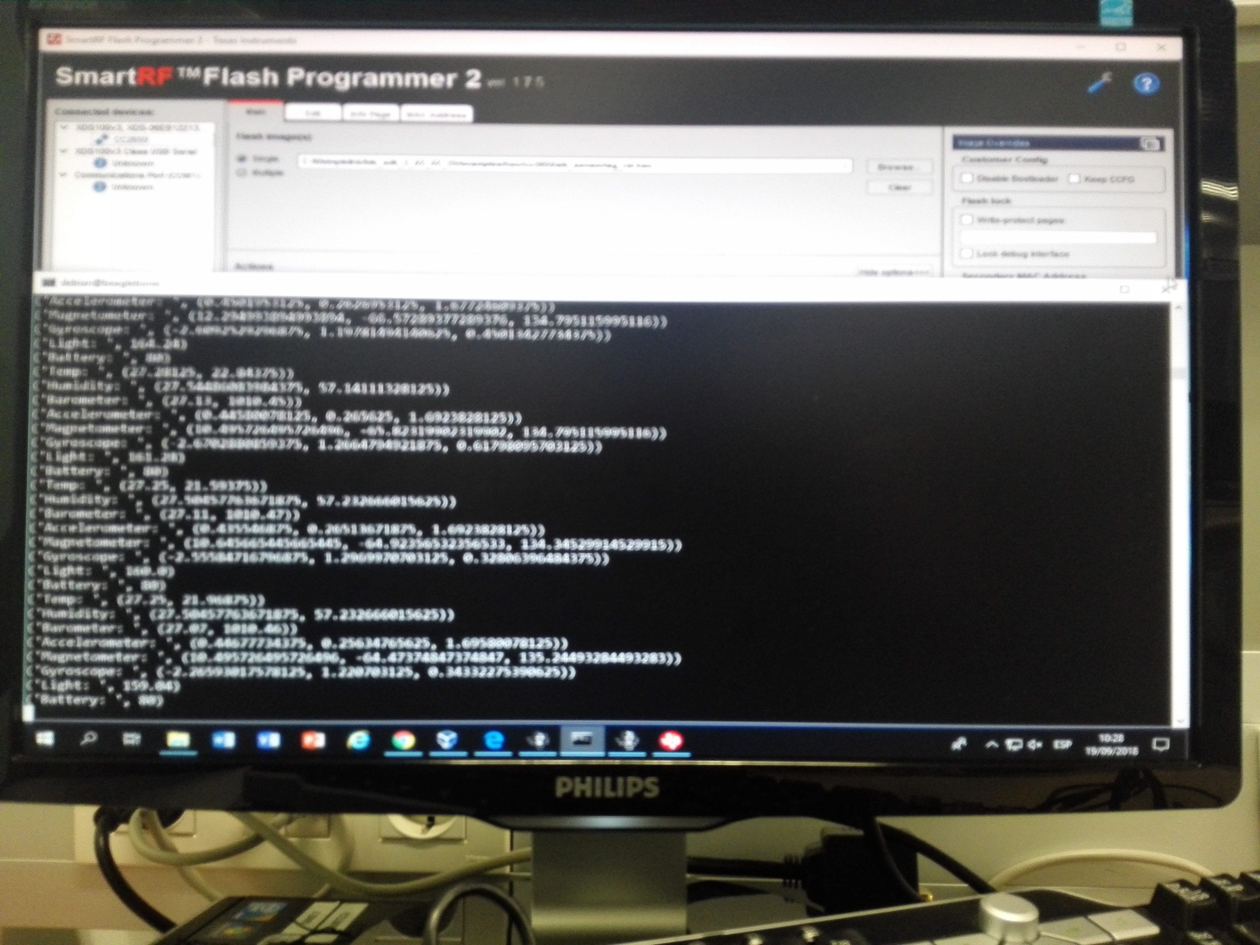

Hi all,
root@beaglebone:~# hciconfig hci0 up
root@beaglebone:~# sensortag 78:A5:04:8C:15:71 --all
Until now, have been impossible with cc2540 connected use this commands. Exist a way to use hcitool, hciconfig with cc2540?
Santiago.
Hi all,
I have installed a bluetooth adapter to beaglebone (pic 1) and using hciconfig hci0 up (activate it) and hcitool lescan allows detecting the sensortag cc2560, and using sensortag MAC(cc2560) -- all (github.com/.../bluepy) was possible reading the sensor information (pic 2).
YiKai Chen, i appreciate your previuos response.
Santiago.
