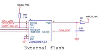

I have two components to communicate via SPI. CC2651R3SIPA is master.
  1. IMU IC - slave
  2. FLASH - slave
My configuration is Multi-Subnode Configuration. Therefore, MOSI, MISO and SCLK lines are shared, and I have two different CS lines for IMU and FLASH.
I looked into schematic of LP-CC2651r3sipa and found that a 2.2K pullup resistor is used.
I know that something between1k to 10k is a good value for a pullup. A simple calculation shows that when CS is low; during communication 1.5mA will be sunk by the pullup. A 10k can bring it down to 0.33 mA.
I have following questions:
  1. SPI doesn't need pullups as it is push-pull, so why do we need to use the pullup here?
  2. Why 2.2k why not a larger value?
  3. Why internal pullup of CS was not used, and instead an external resistor used - in that case pin shall sink much lesser current?
  4. Shall we require a pullup for MISO too in case we have multiple slaves?
Please give some advice,
Thanks.
  • Hi Santosh,
    1. The pull-up is there to give this nCS noise immunity and depending on your system requirement it can be remove.
    2. Using a 10k ohm resistor would trade noise immunity for lower current consumption. We prefer to guarantee performance hence the 2.2K ohm resistor.
    3. This ties back to #1 and #2. The internal pull up resistance is higher which would draw a lower current but at the cost of noise immunity.
    4. In general, yes but it really depends on your system requirements.
