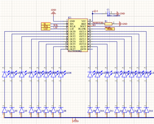

TLC5928: Constant current and Voltage to switch on and off pin diodes
Part Number: TLC5928
As per datasheet TLC5928 is used as a LED Driver with constant current sink.
In our application we want to use TLC5928 such that it can provide constant current and voltage to led and pin diodes. Also we want to toggle the pin diodes to switch on and off conditions as per requirement.
In one paper we got the reference for this. But we are unable to understand how constant VLED voltage at anode side of pin diode will toggle the pin diode and LEDS both.
Kindly help to understand this
