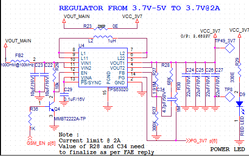

    For TPS63020, As we checked datasheet , Value of VFB = 500mV. So, We have used R27 : 1.91M and R37 : 300K and R28 , C34 will be used for transient response.
    If we changed the value of R37 from 300K to 53K then value of  R27 : 300K will be used. Does our understanding correct?
    For your reference, Please find the attached image.
    kindly help to advice here.
  • Yes, this is correct.
