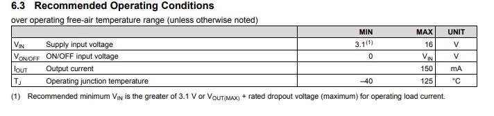

We are trying to use the 3.3 V LDO regulator to step down a 9 V battery. It is working correctly and it says on the data sheet that it can handle voltages up to 16 V, but I am concerned about it being able to handle the power dissipation (@9V and below)Will it be able to handle it? Also is there any data about the power dissipation that you would be able to share?

    The amount of power that can be dissipated depends on application specific conditions including heatsinking, ambient temperature, air flow, etc.  Often before a board is laid out the best way to estimate if a device is adequately able to dissipated the intended power, we use the junction to ambient thermal resistance and the rated junction temperature of the device.  LP2985-N is rated for the conditions listed in the Recommended Operating Conditions.
    The power you intend to be dissipated in your application can be calculated as Pd = (Vin - Vout) * Iout.  You already have stated that you will have a headroom of 5.7 V (Vin- Vout).  If you plug in your load current you will have your intended power dissipation.
    We can look up the junction to ambient thermal resistance in the Thermal Information table:
    Now we have all the information needed to estimate what the junction temperature would be in your application using the following equation:
    Tj = Pd * RθJA + Ta
    From the Recommended Operating Conditions we know that the maximum rated junction temperature is 125 C.  If your estimated junction temperature is below 125 C, then LP2985-N is adequate for your intended power dissipation.  If not, you will want to either consider another device or adjust your application by reducing the headroom (Vin - Vout).  You could do this by using a DCDC before the LDO (most power efficient), using another LDO (highest system PSRR), or even a power resistor in series before the current LDO.  All of these will reduce the power dissipation in the LDO.
