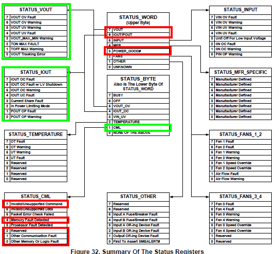

We are experiencing the below issue:
  • After the chips are configured, tried to turn on the voltage rails by writing OPERATION_ON and pull pin PMBUS_CTL high. The rails remain low.
  • Checking the status registers, I got:
  • STATUS_MFR_SPECIFIC: 0x80
  • STATUS_WORD: 0x00c8
  • STATUS_CML: 0x97
  • Sending SOFTRESET does not help with the issue.

  • Best option moving forward is to provide the configuration file for the UCD9246 and the power schematic.  nRESET should be tied to 3V3 by resistor 10K pull-up, including a 10nF capacitor wouldn't hurt either.  Prefer nRESET is not actively used to control power circuit, PMBus_CTRL pin or OPERATION command to enable/disable rails.  Some customers like to include the ability to cycle this pin as a last ditch option but it has never been shown to be needed.
    1) STATUS_MFR_SPECIFIC: 0x80
    This is a CLF (Current Limit Flag) which is triggered by the internal overcurrent comparator (vs. FLT which is often an OC triggered by the driver circuitry).  It is a paged fault so it would be specific to a particular rail.  Probable older logged fault as MFR bit in STATUS_WORD not set.
    2) STATUS_WORD: 0x00c8
    Multiple items - Can be Error or Current State (sent Little Endian so bytes need to be reversed to 0xc800)
    VOUT (There should be corresponding STATUS_VOUT register value that provides additional info)
    IOUT (There should be corresponding STATUS_IOUT register value that provides additional info)  Likely bit 7 (IOUT_OC_FAULT)
    POWER_GOOD# - Rail is OFF
    3) STATUS_CML: 0x97
    A few items here shown below, appear to be old logged faults as the CML bit is not set in the STATUS_WORD.  Likely from attempting to write while part is initializing or shutting down.
