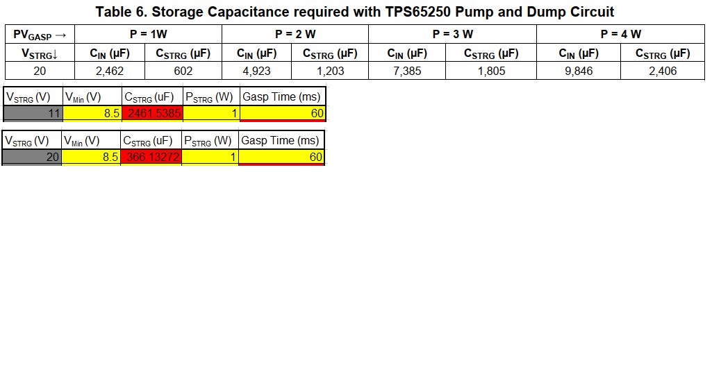

do you have any about pump and dump calculated  tool? because the datasheet dose not into detail.
i have some question;
I would like to know how to calculate the CSTRG for meet the Table 6 in datasheet.
In fact, I can make a table to duplicate the CIN value but I can't duplicate the CSTRG. Please help to offer a formula to me then it can meet the table 6, I would like to know what's difference?
