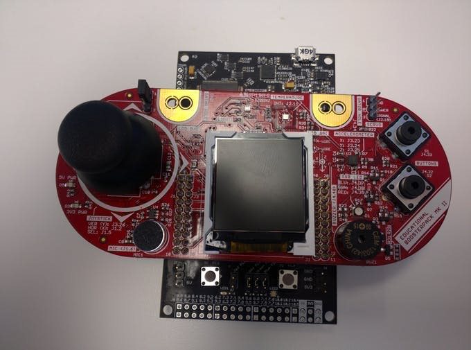

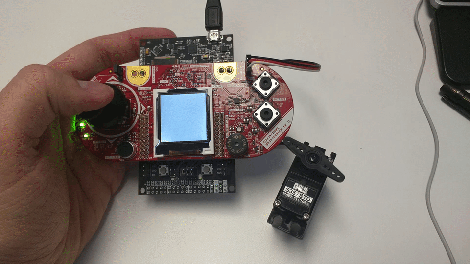

Lab 1:  Spin a Servo
In this lab, we will use the Educational BoosterPack MKII (Edu BP MKII) to spin the servo motor. The goal of this lab is to familiarize the student with the concept of a BoosterPack plug-in module and how software libraries can speed development of advanced applications. You can find the example code inside of Energia and on www.energia.nu/edumkii.
Diagram of a Servo.  In our use case, the Joystick is the potentiometer.
1. Plug the Educational BoosterPack MKII into the MSP432 MCU LaunchPad kit's BoosterPack headers.
2. Plug the Servo connector into the servo header on the EDU BP. Make sure the white wire is connected to SIGNAL, the red wire is connected to POWER, and the black wire is connected to GROUND.
3. Connect your MSP432 MCU LaunchPad kit to your computer. Navigate to File > Examples > EducationBP_MKII > ServofromJoystick.
4. In the setup() function, add the following line:
analogReadResolution(12);
This tells the LaunchPad kit what resolution to use when reading analog values.  Your setup function should now look like this:
void setup() {
  myservo.attach(19); // attaches the servo on pin 9 to the servo object
  analogReadResolution(12); // set the analog read resolution to 12 bits
5. Click the red upload arrow.  After compiling and download, your code will start running! Use the joystick to move the servo left and right. Verify your servo is moving properly.

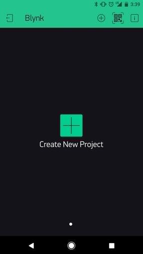

In this lab, we are going to use an app called Blynk to spin a servo from a smartphone. The goal of this project is to get an MSP432 MCU + CC3100 wireless network processor connected to a Blynk app on either your Android or iOS device. Blynk is an IoT platform that lets you create a custom mobile app to communicate with an internet connected microcontroller.
1. First, let's create the mobile application. To start, create a Blynk account by installing the Blynk app on your Android or iOS device. You'll need to create a new account. Once you create your account, you should see this screen. Click the + button to create a new project.
2. In the app, click the + button to create a new project. Name your project, and select TI-CC3200-LaunchXL for your hardware. The connection type will be WiFi.
