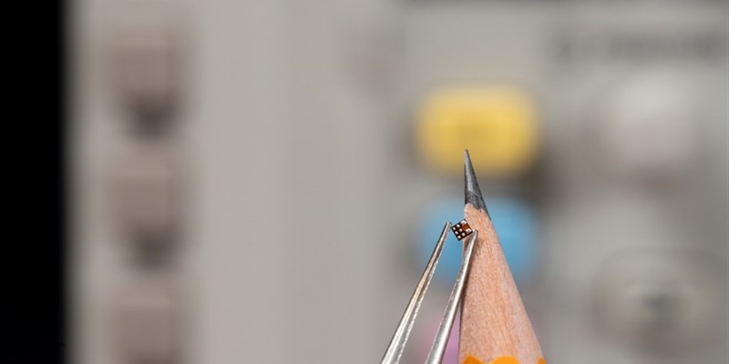

Digital EZShunt products greatly reduce design size. For example, the INA700 digital power monitor reduces component area size as much as 84% when compared to a similar wafer chip-scale package digital power monitor plus a 1206 shunt.
