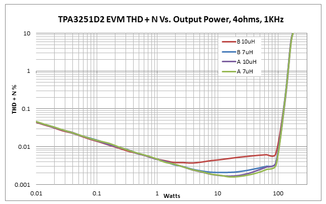

I then tested these inductors on the TPA3251D2 evaluation module (EVM) and the results were clear, as you can see in Figures 1 and 2.
Figure 1: TPA3251D2EVM plot of output power and THD+N for measured inductors

From the data collected from the TPA3251D2EVM, the 10µH inductor from manufacturer A outperforms manufacturer B’s 10µH and 7µH inductors. If I were to select manufacturer B’s 10µH inductor, the THD performance of the amplifier would be limited to 0.0045% at 10W, compared to 0.0017% for the manufacturer A’s 10µH inductor.
Also notice that at 20W, the THD vs. frequency performance improves significantly. If you were designing an LC filter around an amplifier where higher THD performance is acceptable, or if the native THD of the amplifier was higher, the 10µH from manufacturer B may be a suitable candidate. In the end, the designer of the system must make a choice between inductor linearity, cost and size.
