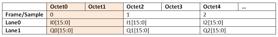

Here’s a real world example to illustrate this process. Let’s assume we’re using the 12-bit, 4GSPS RF-sampling ADC12J4000, which is sampling at 3.1Gsps. The DDC block within the ADC then down converts the ADC samples and decimates the data by 16x. This produces 16-bit complex I and Q data at 193.75Msps. Since the data is 16-bits wide, you’ll need 2 octets per 16-bit sample. The JESD204B standard employs 8b/10b encoding, so each octet will require 10 bits. The total throughput can then be calculated as:
Datarate*Num_Converters*Num_Octets*10bits/Octet=
193.75Msps*2*2*10=7.75Gbps Total throughput
You can then spread this throughput across a number of lanes. For example, if 2 lanes are used, the lane configuration would be LMFS=2221, with each lane at 3.875Gbps.
L=2 lanes
M=2 logical converters (I and Q)
F= 2 octets per frame
S= 1 sample per frame
The resulting ADC link structure would be as follows:
Table 1. Frame structure for LMFS=2221, 1 sample across 2 octets
