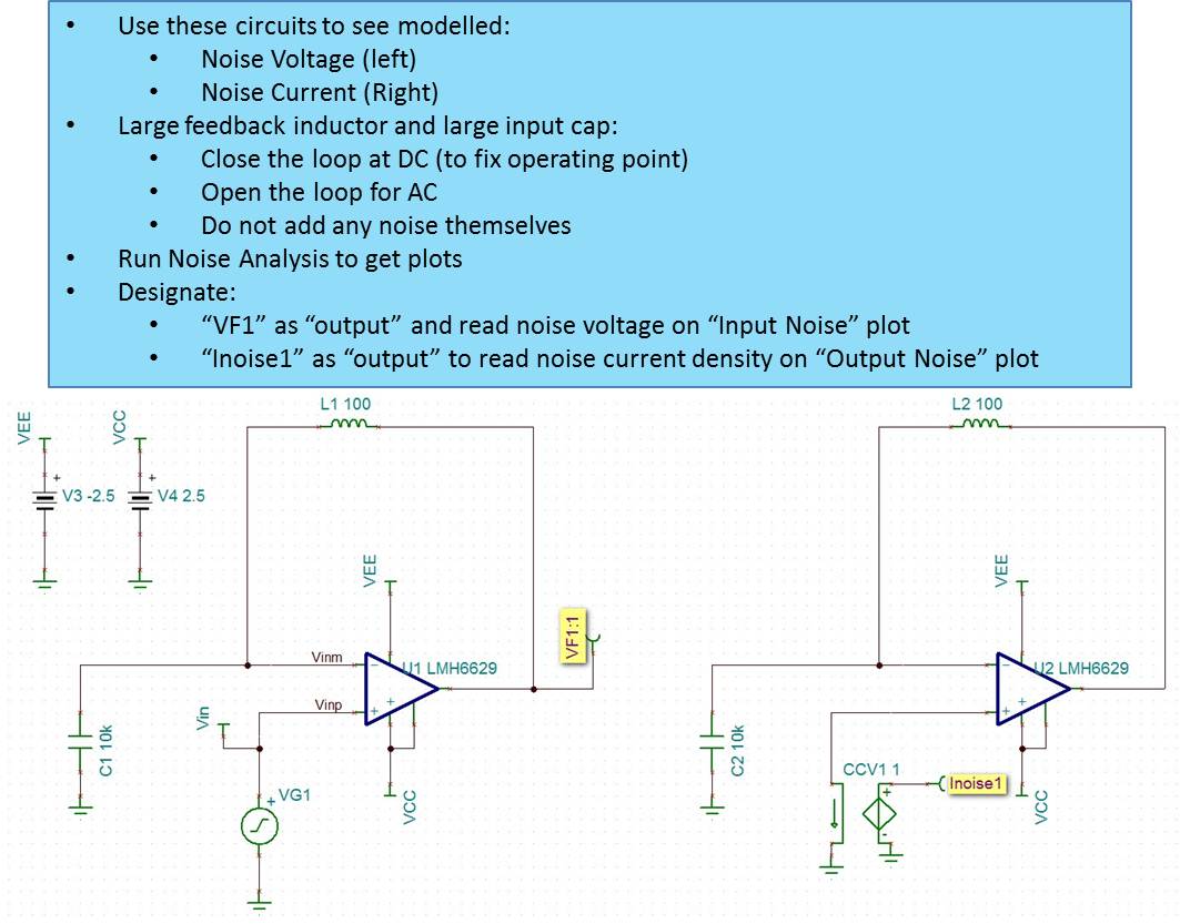

If you doubt how accurate your device noise model is, use the simulation circuits in Figure 4 to generate the plots (Figure 5) which you can then compare with the datasheet:
Figure 4: Uncovering the modelled noise of a device
Figure 5 shows the plots generated by noise-simulating the Figure 4 circuits. Results confirm good agreement with LMH6629 datasheet plots!
Figure 5: LMH6629 TINA-TI noise model matches well with datasheet
