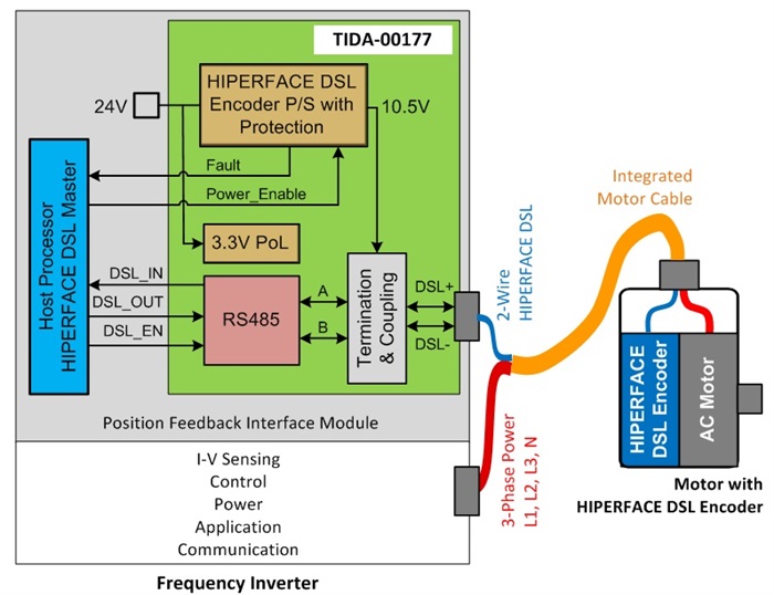

Figure 3 is a simplified system block of a servo drive with a master interface to a HIPERFACE DSL encoder.
Figure 3: TIDA-00177 TI Designs reference design system overview
