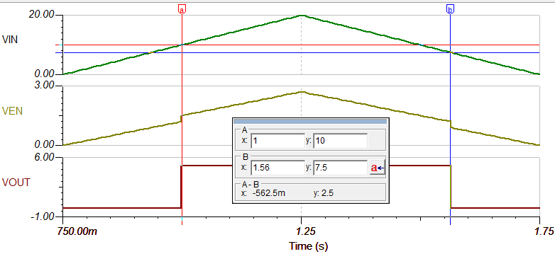

Click Analysis and then Transient Analysis to run the simulation. Running from 750ms to 1.75s will show a full turnon, turnoff cycle. Figure 3 shows the simulation results.
Figure 3: TINA-TI Simulation Transient Results

The Excel calculator allows for quick design of a hysteresis network. The simulation files prove the mathematical validity, showing the same turnon and turnoff threshold as the calculator. Finally, testing in the lab proves that at the applications level, the turnon and turnoff thresholds are very close to the ideal, corresponding to the calculator. The Excel calculator, simulation tools and EVM testing provide a quick and accurate method to add hysteresis to your DC/DC converter.
