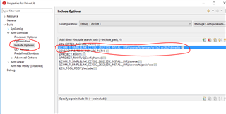

    BTW, I also add include path in properties as below:
    And the PRCMxxx() is reside in simplelink_cc13x2_26x2_sdk_4_30_00_54\source\ti\devices\cc13x2_cc26x2\driverlib.
