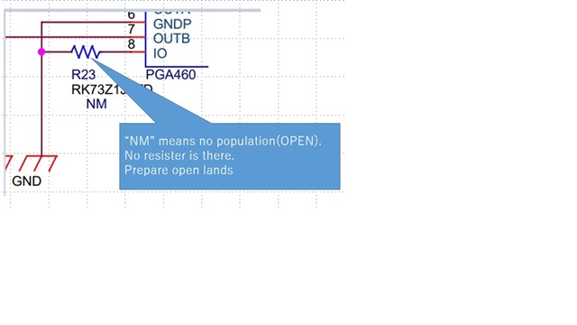

    We already built the desinged board including the IC and drivers.
    About attached 1st figure;
    I will attach some OSC waveform. upper one is sending command and lower is response.
    I have no capability of logic analyzer now, so I read out bit data according to the location of 2x stop(Hi) bit and 1x start(Lo) bit position.
    *One point, you can see the same waveforms on both, becuase our board has other converter circuit,
    Uart signal goes to CAN tranceiver to initiate differential signal to send to twist pair lines and converted again to reciever side,
    so "echo" signals are presented. I connected our UART sigal to TI borad just beofre PGA460 input(TXD, RXD).

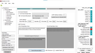

  • Dear Mekre.
    I found the reproducing procedure even at PGA460-Q1 EVM, not from our H/W about this.
    1. connnect TI board to PC, uart address is 0.
    2. then at Interface Mode, send  CMD 25 (Threshold bulk write, sam as CMD 16)
    write the following data
    81445660000499CE739CE738C8C8C80081445660000499CE739CE738C8C8C800
    3. Then read 5F reg value by changing the baudrate from 115.2k to 57600.
    please see attached screen shot. You can see different response....
    I guess, even if I send register write command, still NVM are not written completely.
    My concerning is our configuration procedure has something wrong, then this issue happend. So, I really need you to check the our configuration procedure and check if something missing.

    After startup, I would expect the THR_CRC_ERR flag to be asserted if you did not write the threshold values yet.  If you try to do a burst and listen operation without setting the thresholds, you also see the following dialog box:
    If you click “Yes” to the above dialog box, the thresholds are initialized to mid-code and the error goes away.  If you manually set the thresholds, this should also clear the THR_CRC_ERR flag.
    Also, I tried the procedure you mentioned and I did not observe any issues.  Here are the steps I followed:
    1. Connect EVM to PC with uart address set to 0.
    2. Send CMD 25 (broadcast threshold bulk write) with the data you mentioned. Here is the resulting screen shot:
    3. Then read 5F reg value. Even with a baud rate of 115200, I see 0x3E as the checksum instead of 0x7E.  Here is the screenshot of this:
    Are you still observing issues when you follow the procedure above?
    Mekre

    Can you tell me if you have the IO pin of the PGA460 connected to anything?
    Mekre
  • Dear Mekre-san,
    Sorry for late notice. I was in hoilday.
    It is OPEN ended.
    But opened land for reisistance is there.
    Rgs,
    Yoshifumi Yamaoka

  • Hi  Yamaoka-san,
    Here is a summary: Since you are not using the one-wire interface, there is no need to enable it.  You can disable this by setting the IO_DIS bit to 1 while IO_IF_SEL=0.
    Mekre
