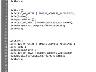

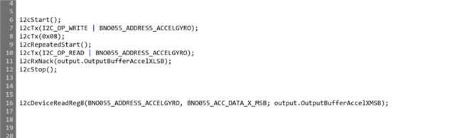

Below I believe it should send the device address, read the register address and then storage the third variable as the read value to the output to be read in the main programme
i2cDeviceReadReg8(BNO055_ADDRESS_ACCELGYRO,BNO055_ACC_DATA_X_LSB; output.OutputBufferAccelXLSB);
U16 eco1;
i2cDeviceReadReg8(BNO055_ADDRESS_ACCELGYRO, 0x05; eco1 );
output.OutputBufferAccelZLSB = eco1;
// Schedule the next execution
fwScheduleTask(1);

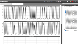

Both of the above functions pass the second variable  through from the sensor controller ram, rather than the value that is supposed to be read into the third variable and passed on into the output, what am I doing wrong?
       DataReadSensorController[0] = scifTaskData.readAndSetupBno055.output.OutputBufferAccelXLSB;
       DataReadSensorController[1] = scifTaskData.readAndSetupBno055.output.OutputBufferAccelXMSB;
       DataReadSensorController[2] = scifTaskData.readAndSetupBno055.output.OutputBufferAccelYLSB;
       DataReadSensorController[3] = scifTaskData.readAndSetupBno055.output.OutputBufferAccelYMSB;
So for instance for the second function function is being read as 0x05 rather than the value within that register
