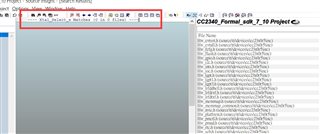

  • Hi Jan,
    I appreciate your help, I encountered a compilation error, I searched the SDK all over the world, but I couldn't find these types, can you give me more information?
    I want to test 32K, can I directly assign clockSrc to 0x07 directly?
    like this.

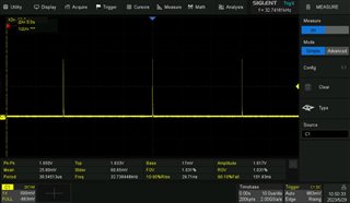

  • Hi Jan
    I compiled the program, but I can't see the 32K square wave on DIO20 or DIO24.
