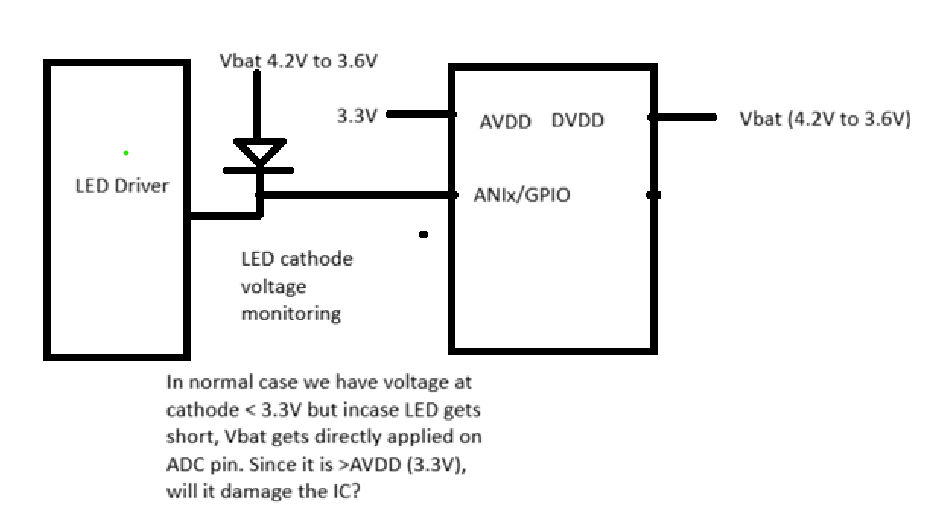

ADS7128: AVDD voltage and ADC channel Input voltage
Part Number: ADS7128
Is this acceptable?
    If the LED is shorted, and up to 4.2V is applied to the input, there is potential to damage the device, if current is not sufficiently limited. In case this does occur, current should be limited to less than 1mA.
