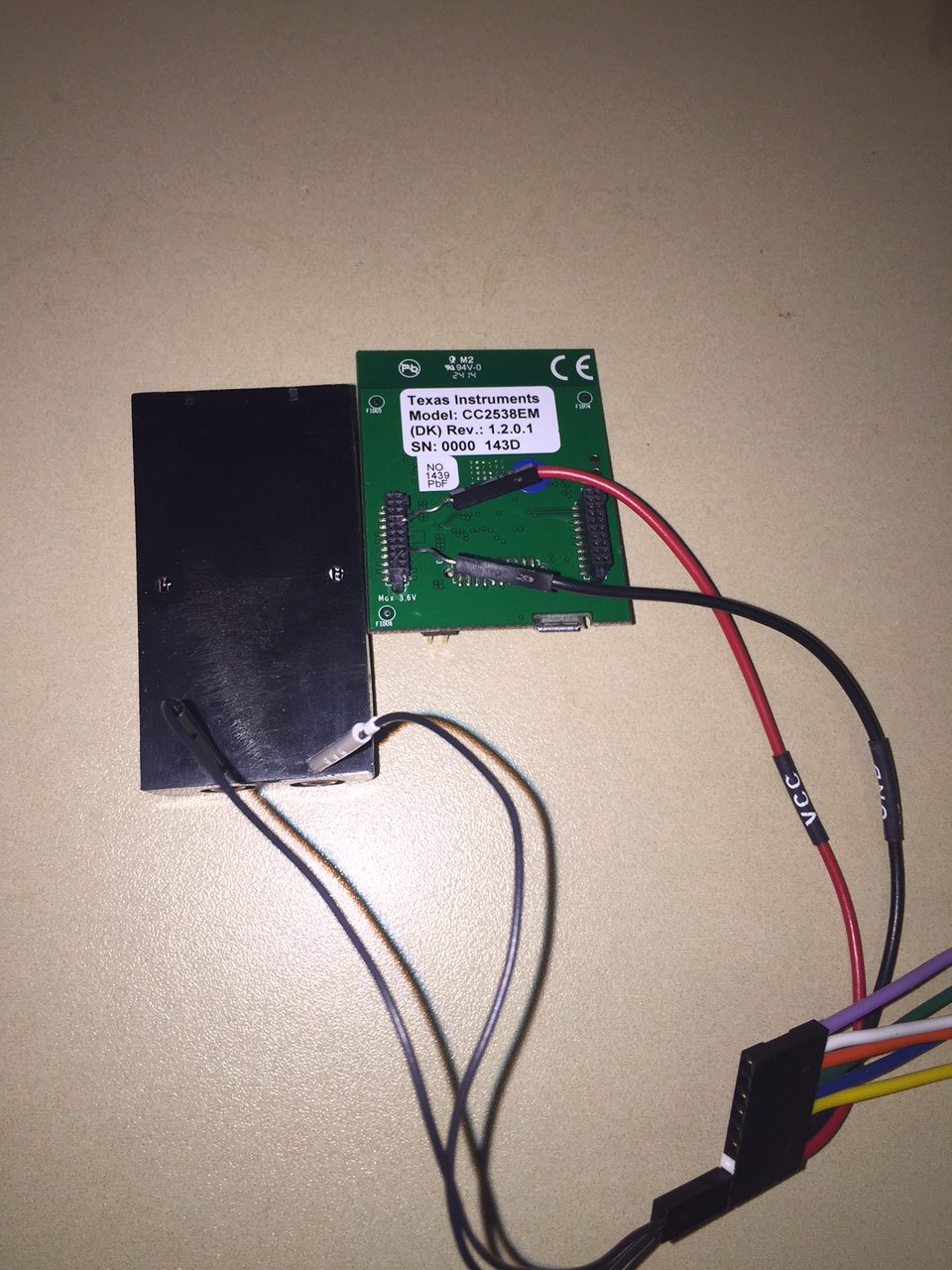

    I put the jumper 1-2, and the battery has the output 3.1 V. Could you help check my connection as shown in the picture? Thanks.
  • There's no indication and how do you know it doesn't work.
  • Following the PER Test program, I let CC2538EM be a transmitter and on my computer I use TI Packet Sniffer to sniff the packets.
    If I power the CC2538EM through USB, I can successfully sniff the packets. Then I switched to the battery power option (as I showed in my last post), then I cannot sniff the packets. Therefore, I sense there might be something wrong with my battery connection setup.
    Thanks.

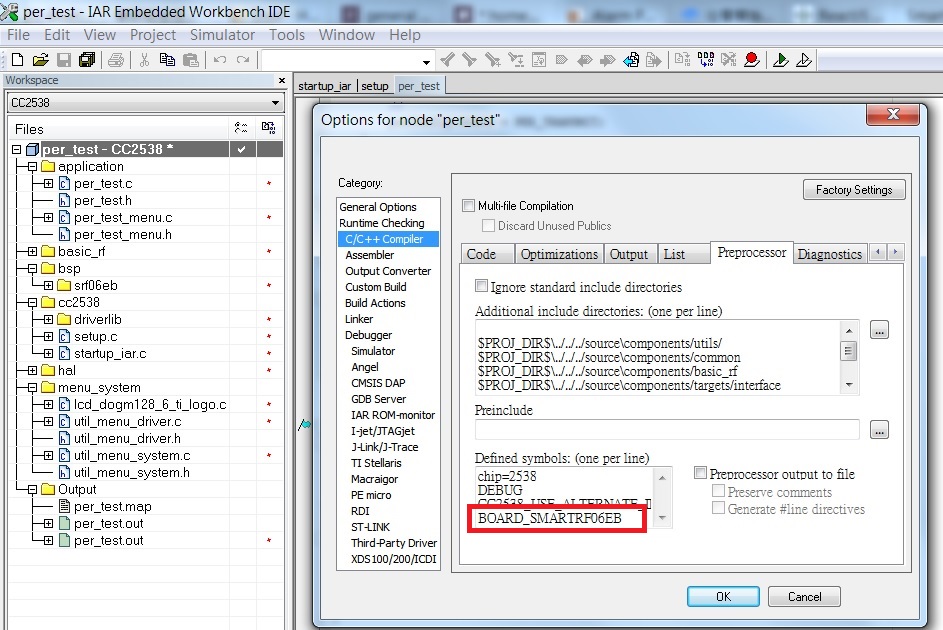

    Also, where is the symbol 'BOARD_SMARTRF06EB' defined? I didn't find it.
    I know you did this long ago :) I appreciate if you can help.
  • It's defined in "Defined symbols" of Preprocessor tab in Project->Options->C/C++ Compiler
