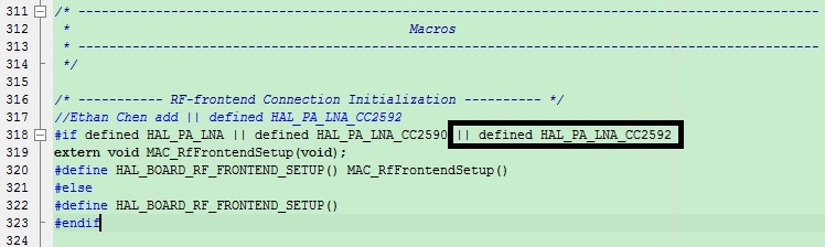

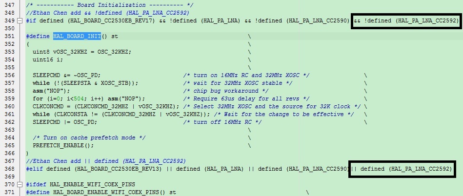

I am using Z-Stack Home 1.2.2a.44539 and I following the wiki : http://processors.wiki.ti.com/index.php/Enabling_the_Support_of_CC259x_PA/LNA_with_Z-Stack-Home-Automation-1.2.1
e2e.ti.com/.../6758.Z_2D00_Stack-Monitor-and-Test-API.pdf

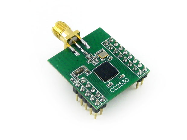

However, when I do connection between the coordination and the client, the distance for connection is so short (smaller than 5 cm).
Can you suggest me what is the problem here?
