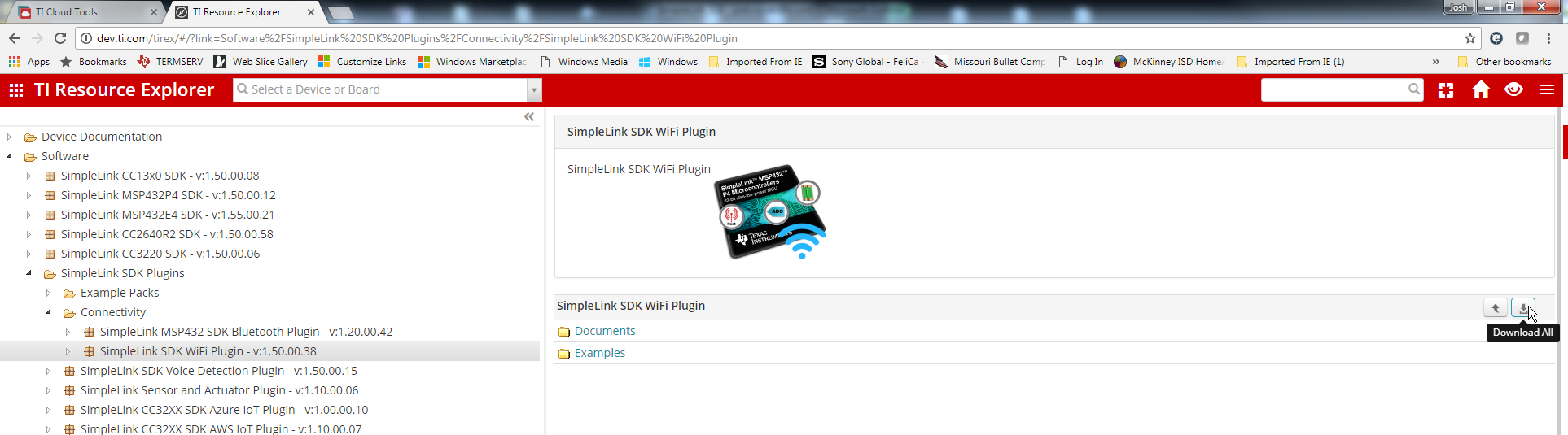

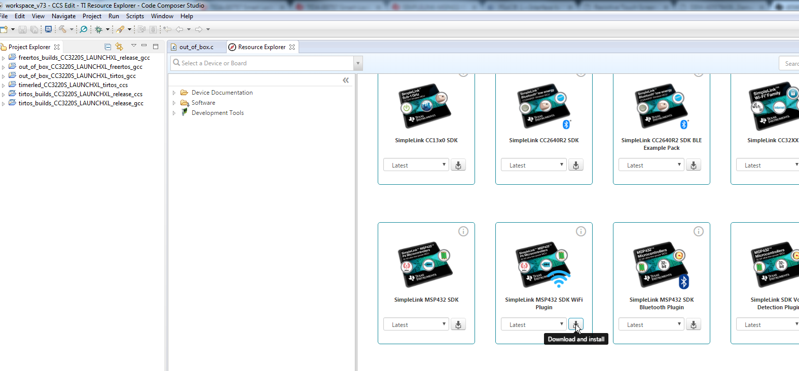

  • Downloading it now. (digressing for a moment...) Of course, I might have known that a new SDK version had been released if TI's notification mechanism for new releases actually worked. The new SDK was released on November 2, TI.com just confirmed that "You already have an alert for SIMPLELINK-WIFI-CC3120-SDK-PLUGIN: SimpleLink™ WI-FI® CC3120 SDK Plugin", and nothing in my inbox, spam, trash, or TI folder resembles a new release notification. Having to set an alert for each individual document or download, and then download and separately install each SDK or tool, is such a dated process, and TI would do well to come up with a more modern way of distributing and deploying its software products. There's no reason why Code Composer Studio couldn't become the hub for these tools, a la Simplicity Studio (Silicon Labs), Atmel Studio (Atmel/Microchip), MPLAB X (Microchip), etc.
  • Dear DR216 -
    FYI, Resource Explorer (inside CCS or the Cloud based version) does have what you describe
    inside CCS ==>
