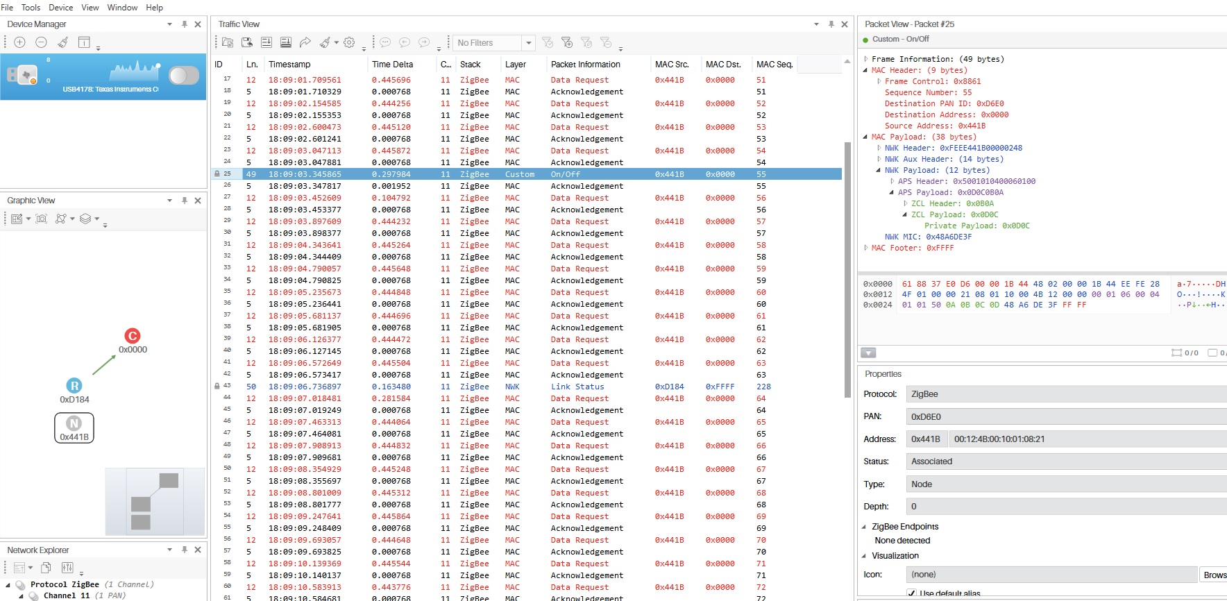

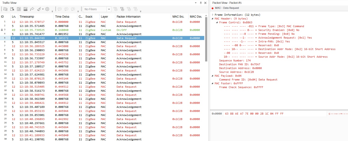

Hi! I try to send data from EndDevice to Coordinator with AF_DATA_REQUEST message via my custom cc2530 ZNP board. But Coordinator does not trigger AF_INCOMING_MSG callback.
I have 3 ZNP devices (cc2530) connected via SPI to my STM32F103ZET6 board. One of device is Coordinator, the second is Router and the EndDevice. After start Coordinator successfully creates network, then Router successfully joined as a router, and after that EndDevice also successfully joined the network. After ED join i try to send data to Coordinator, i send AF_DATA_REQUEST to EndDevice ZNP, it respond me with status=0 (success), after that i receive MT_AF_DATA_CONFIRM from EndDevice. But there is no AF_INCOMING_MSG at Coordinator device.
Should i create binding between ED and Coordinator before send messages? As i see in example in swra444.pdf binding is not required to send data between devices?
Also i tried allow bind at coordinator and send bind request to ED, but AF_DATA_REQUEST still not gave any succes ((
What im doing wrong?
Also this is my simple prinf log from IAR terminal )
ID:1 - Coordinator, ID:2 - Router, ID:3 - EndDevice

[ID:1][AREQ][ZDO]Length[13], cmd0[45], cmd1[C1], payload [84:D1:84:D1:00:08:01:10:00:4B:12:00:8E]
 MT_ZDO_END_DEVICE_ANNCE_IND
[ID:1][mtZdoEndDeviceAnnceIndCb] SrcAddr [D184], NwkAddr [D184], Capabilities[8E]
[ID:1][AREQ][ZDO]Length[12], cmd0[45], cmd1[CA], payload [84:D1:00:08:01:10:00:4B:12:00:00:00]
 MT_ZDO_TC_DEVICE_IND
[ID:1][mtZdoTcDeviceIndCb] NwkAddr [84D1], ParentAddr [00]
[ID:1][SREQ][ZDO]Length[16], cmd0[25], cmd1[21], payload [D1:84:00:08:01:10:00:4B:12:00:01:06:00:00:FF:FF]
[ID:1][SRSP][ZDO]Length[1], cmd0[65], cmd1[21], payload [00]
 MT_ZDO_BIND_REQ

[ID:3][AREQ][ZDO]Length[1], cmd0[45], cmd1[C0], payload [06]
 MT_ZDO_STATE_CHANGE_IND
[ID:3][mtZdoStateChangeIndCb] Started as device after authentication
[ID:2][AREQ][ZDO]Length[13], cmd0[45], cmd1[C1], payload [1B:44:1B:44:21:08:01:10:00:4B:12:00:80]
[ID:1][AREQ][ZDO]Length[13], cmd0[45], cmd1[C1], payload [1B:44:1B:44:21:08:01:10:00:4B:12:00:80]
[ID:1][mtZdoEndDeviceAnnceIndCb] SrcAddr [441B], NwkAddr [441B], Capabilities[80]
[ID:1][AREQ][ZDO]Length[12], cmd0[45], cmd1[CA], payload [1B:44:21:08:01:10:00:4B:12:00:00:00]
[ID:1][mtZdoTcDeviceIndCb] NwkAddr [1B44], ParentAddr [00]
[ID:1][SREQ][ZDO]Length[16], cmd0[25], cmd1[21], payload [44:1B:21:08:01:10:00:4B:12:00:01:06:00:00:FF:FF]
 MT_ZDO_BIND_REQ
[ID:3][SREQ][AF]Length[14], cmd0[24], cmd1[01], payload [00:00:01:01:06:00:00:00:EE:04:0A:0B:0C:0D]
[ID:3][SRSP][AF]Length[1], cmd0[64], cmd1[01], payload [00]
 MT_AF_DATA_REQUEST
[ID:3][AREQ][AF]Length[3], cmd0[44], cmd1[80], payload [00:01:00]
afProcess: MT_AF_DATA_CONFIRM
[ID:3][mtAfDataConfirmCb] Status [00], Endpoint [01], TransId [00]
[ID:3][SREQ][AF]Length[14], cmd0[24], cmd1[01], payload [00:00:01:01:06:00:01:00:EE:04:0A:0B:0C:0D]
 MT_AF_DATA_REQUEST
[ID:3][AREQ][AF]Length[3], cmd0[44], cmd1[80], payload [00:01:01]
[ID:3][mtAfDataConfirmCb] Status [00], Endpoint [01], TransId [01]
