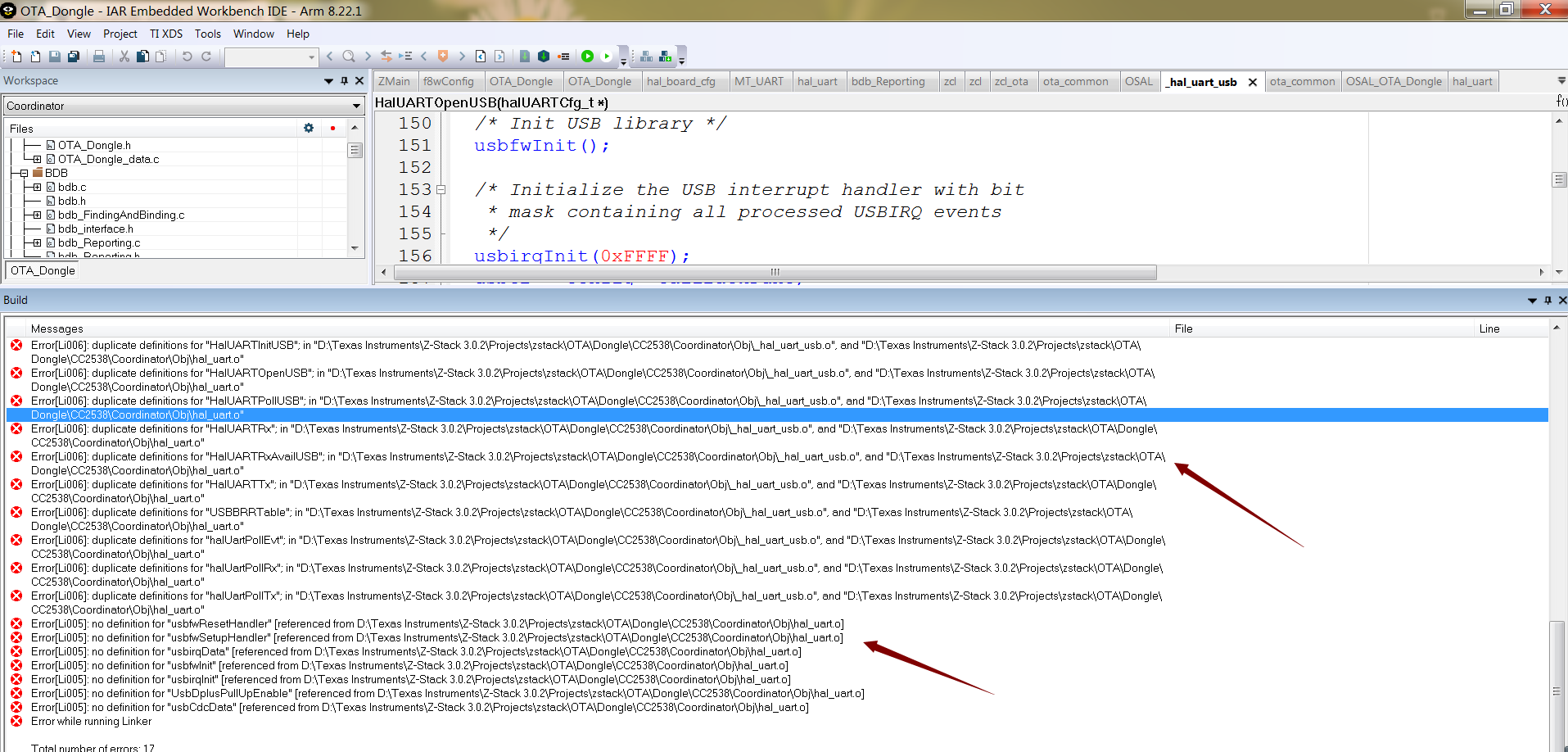

2.So in order to solve the fist problem.I change the UART to USB,and appeared the error on the IAR FOR ARM 8.22.1
So What I can do for it?
Thanks!
  • It seems that you add source files contain those Functions twice in your project.
  • Hi userjiabo,
    I suggest you define HAL_UART_USB and USB_SETUP_MAX_NUMBER_OF_INTERFACES=5, add $PROJ_DIR$\..\..\..\..\Components\usblib\cc2538\bin\iar\usbcdc.lib to Options -> Linker -> Library, and include the following directories to Options -> C/C++ Compiler -> Preprocessor:
    $PROJ_DIR$\..\..\..\..\..\Components\usblib\cc2538\source\library
    $PROJ_DIR$\..\..\..\..\..\Components\usblib\cc2538\source\library\cc2538
    $PROJ_DIR$\..\..\..\..\..\Components\usblib\cc2538\source\class_cdc
    Ryan

    also the IAR FOR ARM 8.22.1 appeared the picture problem:
    Thanks!

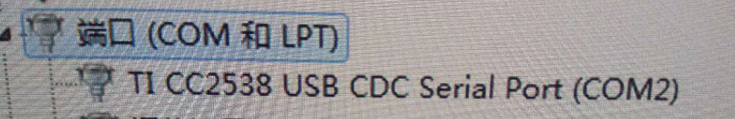

  • Hi YiKai Chen
    What can I install this USB port.
    I want to install on my PC. I had forgot and can not find about this.
    Thanks!
  • I couldn't understand your question. The screenshot shows your PC already install CDC driver for CC2538 properly.
  • Hi YiKai Chen
    yes,notebook can not install,this is the computer can install it, where the usb driver I can find to install it,I had found,but found no.
    Thanks!
  • Attach driver for your reference.
    drivers.zip
  • Hi YiKai Chen
    Ok,mark!
    Thanks!
  • I had no build errors when all instructions provided were completed for an out-of-box GenericApp example.
    Edit: Same for ZC OTA Dongle project
    Ryan
  • Hi Brown1
    yes,I had build on the an out-of-box GenericApp example also the same result to you,but now on the dongle example had appeared this,
    So strange?
    Thanks!

  • I don't see any build errors for the ZC OTA Dongle project as well, using the same steps as before.  Perhaps you should try evaluating a new stack installation.
    Ryan
  • Hi Brown1
    OK,I wll try again.
    Thanks!
  • Hi Brown1
    ok,I had try again and had no any error during build the dongle project.
    and the USB protocol can be enabled and the tramit and receive successfully.
