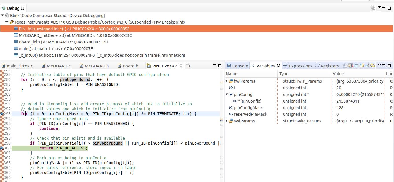

Problem
I noticed that the output is not generated as expected. After debugging I found out that,
main_tirtos.c
    int main(void) -->
        Board_init() -->
MYBOARD.c
    void MYBOARD_initGeneral(void) -->
        if (PIN_init(BoardGpioInitTable) != PIN_SUCCESS) -->
PINCC26XX.c -->
    PIN_Status PIN_init(const PIN_Config pinConfig[]) -->
        for (i = 0, pinConfigMask = 0; PIN_ID(pinConfig[i]) != PIN_TERMINATE; i++)-->
            // Check that pin exists and is available
            if (PIN_ID(pinConfig[i]) > pinUpperBound || PIN_ID(pinConfig[i]) < pinLowerBound || reservedPinMask & (1 << PIN_ID(pinConfig[i]))) {
                return PIN_NO_ACCESS;
This PIN_NO_ACCESS causes a the app to stay on while(1)
if (PIN_init(BoardGpioInitTable) != PIN_SUCCESS) {
        /* Error with PIN_init */
        while (1);
The screenshot below shows the value of variables,watch expressions at the time of failure.
I even tried this BLE-Stack-Debugging Guide, but realized that it is does not relate to the TI Dirver example I am running. I need to atleast blink an LED before moving onto BLE.
What could be the reason for this? How can I resolve this?

  • A RHB package as you use has fewer DIOs than the 7x7 package you have copied the board files from. Basically you have to comment out the DIOs in the board files that doesn't exist on a RHB.
    See https://dev.ti.com/tirex/explore/node?node=APZDQGM5GQ3GRFe6OmUZCg__krol.2c__LATEST and
    to give you an idea.

        CC2640R2_LAUNCHXL_GPIO_SPI_FLASH_CS,
        CC2640R2_LAUNCHXL_SDSPI_CS,
        CC2640R2_LAUNCHXL_GPIO_LCD_CS,
        CC2640R2_LAUNCHXL_GPIO_LCD_POWER,
        CC2640R2_LAUNCHXL_GPIO_LCD_ENABLE,
        CC2640R2_LAUNCHXL_DIO12,
        CC2640R2_LAUNCHXL_DIO11,
        CC2640R2_LAUNCHXL_DIO10,
        CC2640R2_LAUNCHXL_GPIOCOUNT
    } CC2640R2_LAUNCHXL_GPIOName;
    In CC2640R2_LAUNCHXL.c
    GPIO_PinConfig gpioPinConfigs[] = {
        /* Input pins */
        GPIOCC26XX_DIO_13 | GPIO_DO_NOT_CONFIG,  /* Button 0 */
        GPIOCC26XX_DIO_14 | GPIO_DO_NOT_CONFIG,  /* Button 1 */
        GPIOCC26XX_DIO_15 | GPIO_DO_NOT_CONFIG,  /* CC2640R2_LAUNCHXL_SPI_MASTER_READY */
        GPIOCC26XX_DIO_21 | GPIO_DO_NOT_CONFIG,  /* CC2640R2_LAUNCHXL_SPI_SLAVE_READY */
        /* Output pins */
        GPIOCC26XX_DIO_07 | GPIO_DO_NOT_CONFIG,  /* Green LED */
        GPIOCC26XX_DIO_06 | GPIO_DO_NOT_CONFIG,  /* Red LED */
        GPIOCC26XX_DIO_30 | GPIO_DO_NOT_CONFIG,  /* TMP116_EN */
        /* SPI Flash CSN */
        GPIOCC26XX_DIO_20 | GPIO_DO_NOT_CONFIG,
        /* SD CS */
        /* Sharp Display - GPIO configurations will be done in the Display files */
        GPIOCC26XX_DIO_24 | GPIO_DO_NOT_CONFIG, /* SPI chip select */
        GPIOCC26XX_DIO_22 | GPIO_DO_NOT_CONFIG, /* LCD power control */
        GPIOCC26XX_DIO_23 | GPIO_DO_NOT_CONFIG, /*LCD enable */
        GPIOCC26XX_DIO_12 | GPIO_DO_NOT_CONFIG, /*TEST LED ADDED BY TMP*/
        GPIOCC26XX_DIO_11 | GPIO_DO_NOT_CONFIG, /*TEST LED ADDED BY TMP*/
        GPIOCC26XX_DIO_10 | GPIO_DO_NOT_CONFIG, /*TEST LED ADDED BY TMP*/
    in the main empty.c,
        GPIO_init();
        /* Configure the LED pin */
        GPIO_setConfig(Board_TESTLED_12, GPIO_CFG_OUT_STD | GPIO_CFG_OUT_LOW);
        GPIO_setConfig(Board_TESTLED_11, GPIO_CFG_OUT_STD | GPIO_CFG_OUT_LOW);
        GPIO_setConfig(Board_TESTLED_10, GPIO_CFG_OUT_STD | GPIO_CFG_OUT_LOW);
        /* Turn on user LED */
        GPIO_write(Board_TESTLED_12, Board_GPIO_LED_ON);
        GPIO_write(Board_TESTLED_11, Board_GPIO_LED_ON);
        GPIO_write(Board_TESTLED_10, Board_GPIO_LED_ON);
        while (1) {
            sleep(time);
            GPIO_toggle(Board_TESTLED_12);
            GPIO_toggle(Board_TESTLED_11);
            GPIO_toggle(Board_TESTLED_10);
    Off she goes,
    Kudos to all contributors!
