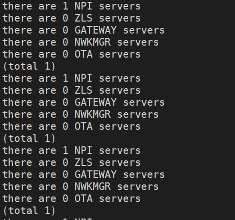

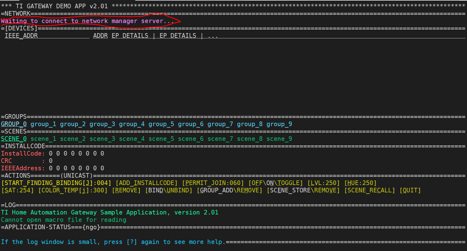

Gateway is not showing server connected to it.
after run "start application" it showing a below result.
"Waiting to connect to network manager server..."
  • Hi Amrut,
    I'm glad to see that you are referencing the Quick Start Guide, also note that there is a Zigbee Gateway SLA available which contains similar instructions.  Can you please provide the full gateway log?  One issue I see is that the ZIGBEE-LINUX-SENSOR-TO-CLOUD firmware does not include images for the LP-CC2652RB which is most likely why the gateway connection to the ZNP is failing.  You will either need to build the ZNP image for the CC2652RB device in CCSTUDIO using the README instructions provided or use a different LaunchPad which is supported by the hex files provided in the software release.
    Ryan
  • It looks like there were some errors during the setup build, you will need to determine the causes of these and check the existend of all *_SRVR_arm targets in your out/Precompiled/servers folder.  There are some different existing Raspberry Pi hardware builds which could be affecting your environment.  Here are the relevant E2E threads I could find:
    https://e2e.ti.com/support/wireless-connectivity/zigbee-and-thread/f/158/t/874019
    https://e2e.ti.com/support/wireless-connectivity/zigbee-and-thread/f/158/t/872605
    https://e2e.ti.com/support/wireless-connectivity/zigbee-and-thread/f/158/t/695887
    https://e2e.ti.com/support/wireless-connectivity/sub-1-ghz/f/156/t/933152
    As mentioned before, you will not be able to use a LP-CC2652RB out-of-box.
    Ryan
  • Hi Ryan,
    Please check the error.
    log:

    ^Ccaught SIGTERM, killing all the servers and cleaning up
    NPI_lnx_arm_server: no process found
    waiting for NPI to exit
    ^Cmaking sure there are no lingering servers...
    there are 1 NPI servers
    there are 0 ZLS servers
    there are 0 GATEWAY servers
    there are 0 NWKMGR servers
    there are 0 OTA servers
    (total 1)
    (total 1)
