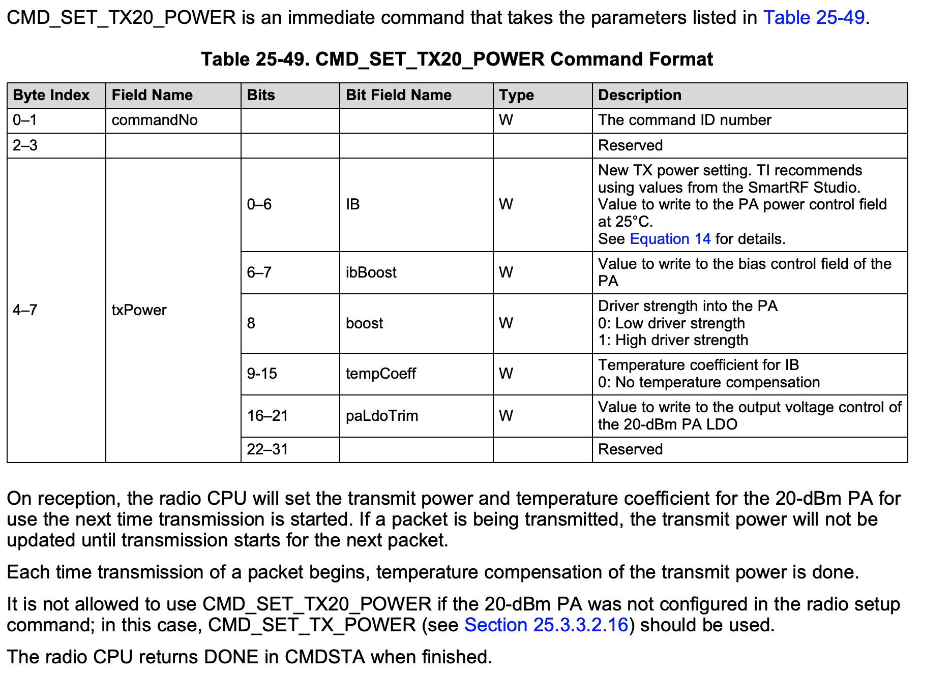

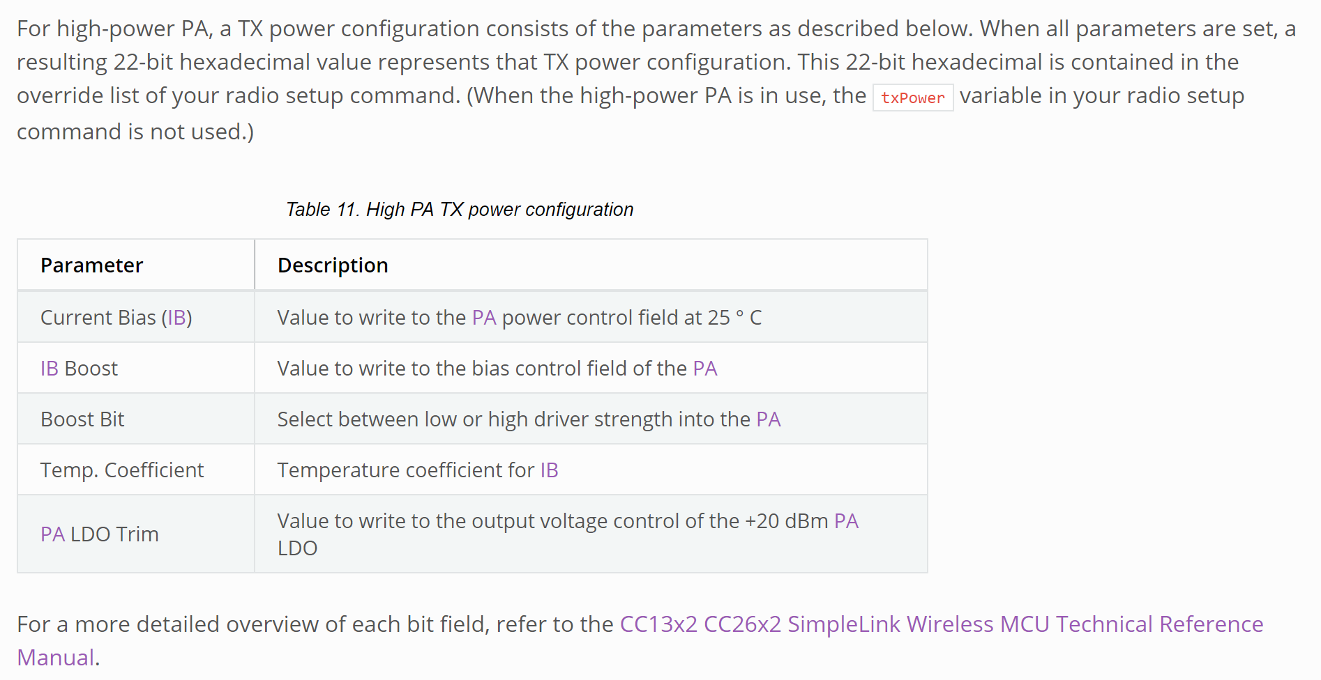

    The only difference between the 15.4 and BLE settings exported from smartRF studio here are the addition of the two lines that "Set VCTRIM to 0 for 20 dBm PA". I have tried with those lines included and excluded and it didn't seem to make a difference in the output power at all. I suspect I should be focusing on the TX20_POWER_OVERRIDE value. I encountered this section within the proprietary RF users guide, for setting the TX power, which describes this override value:
    I assume this table is describing the override value for the TX20_POWER_OVERRIDE command. I also checked the TRM to get the detailed overview of the bit fields. Screenshot of that is attached:
    Here, it says I should use the values from SmartRF studio, which I already am. Based on these bit field descriptions, I deconstructed the 0x003F75F5 override value provided by smartRF studio.
    IB: 63
    ibBoost: 1
    boost: 1
    tempCoeff: 87
    paLdoTrim: 53
    Which of these values should I change to get get the full output power for proprietary? If it's not this, what else should I be looking at?
    For additional context, my proprietary PHY is GFSK, 50 kbps. I'm taking my measurements using a CMD_TX_TEST command, with an unmodulated carrier wave.
    Markus
    Using the LAUNCHXL-CC1352P-2 and SmartRF studio, the 20 dBm PA can be evaluated with the 15.4 PHY. Please use these settings to evaluate your PA design section. With these settings what output power are you measuring ?
       Richard
