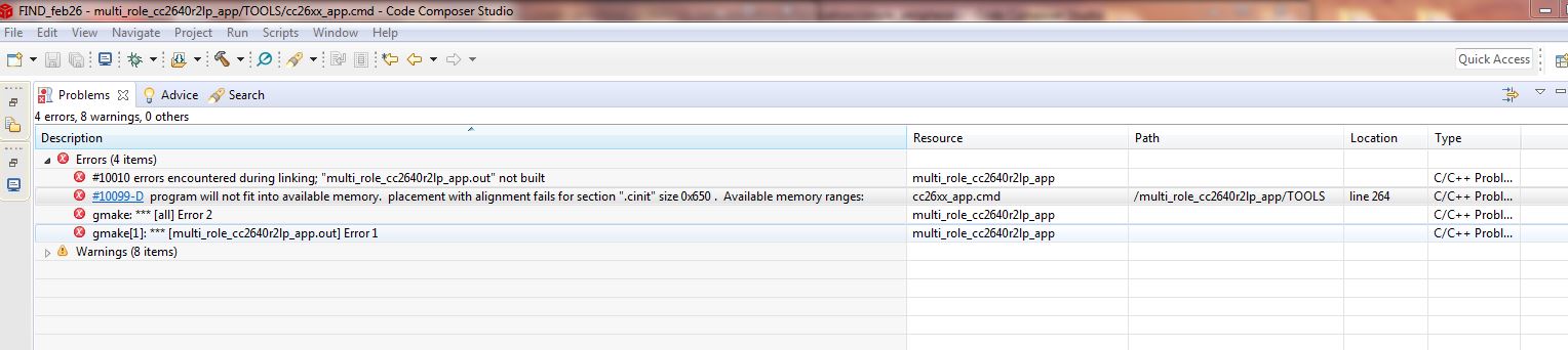

Now we are migrating same in 4.2 stack SDK in multi role project.
But we are facing some issue in code memory after migration .
In CCS after building it is showing error like  memory will not fit for code.
How to solve this issue or any modification is needed 4.2 stack for RTC  or any other modification needed when  going from one stack to different stack for RTC.

  • Hi Rafael,
    Thanks for reply.
    "In the meantime, can you please provide the full Console build output with the entire build error? This will help further diagnose this."
    Yes Sure .
    PFA  following log for you reference

  • Hi Rohit,
    Your project is not linked because of Flash limitation.
    You should find a way to reduce the Flash consumption or migrate to a different device (CC2642R).

  • Hi Rohit,
    As I already mentioned, to solve the link issue, you should find ways to reduce the Flash consumption by clicking here.
