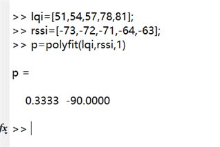

I test this in dataIndCb which support LQI and RSSI both.
And I get data as below:
RSSI : -73dBm, LQI : 51
RSSI : -72dBm, LQI : 54
RSSI : -71dBm, LQI : 57
RSSI : -64dBm, LQI : 78
RSSI : -63dBm, LQI : 81
Do plot in MATLAB is below:
It's very linear. Using polyfit in MATLAB as below
It shows that RSSI = LQI * 0.33 - 90.
So, two results about relationship between RSSI and LQI, which one is correct?
Thanks.
  • Hey yingtao,
    Thank you for providing the results of your investigation.  I checked the MAC source and Hector's formula is still applicable.  However, ED_RF_POWER_MAX_DBM has been modified to -5 dBm as well as ED_RF_POWER_MIN_DBM to -90 for this device family.  With these values, I get the exact same formula you've deduced.

  • Hi YingTao and Ryan,
    Formula and (-5dBm and -90dBm) has been verified on ti154stack and zstack of simplelink_cc13x2_26x2_sdk_4_40_04_04.
    LQI = (MAC_SPEC_ED_MAX * (RSSIdbm - ED_RF_POWER_MIN_DBM)) / (ED_RF_POWER_MAX_DBM - ED_RF_POWER_MIN_DBM);
    where MAC_SPEC_ED_MAX = 255, ED_RF_POWER_MIN_DBM = -90,ED_RF_POWER_MAX_DBM = -5
