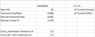

Need design review for INA290, want to make sure the current rating and voltage will drop across:
Hello Shyam,
For the Max Current of 36.7A the output of the INA290 will not be valid.
with INA290A2 is 50 V/V
Vout at max current = 36.7A *2mΩ* 50V/V = 3.67V which is larger than Vsupply and will not be valid.
Max Vout = 3.3V- 0.025V(Swing High) = 3.275V
Therefore the max current is calculated below with the specifications. Please keep in mind the tolerances where not included. Normally the largest tolerance is normally the resistor value.
3.275 / 50V/V / 2mΩ = Max Current measurement valid = 32.75A
Hi Javier,
LM5069 current limit is set at 36.7A, for worst case scenario, however, the actual current doesn't go over 33A. Here is the calculation:
Also, the 2mR I am using is part number: KRL6432E-M-R002-G-T1 (3W). Do you see any potential issue due to the wattage rating of the resistor?
Hello Shyam,
Just recall you will not be able to get up to 3.3V if your supply is 3.3V due to swing high limitations. As for the resistor you are correct that the resistor can handle the current at room temperature. Please be aware that the resistor degrades with ambient temperature. Also the resistance will change with the temperature change at 100ppm/°C. I could not find the package dissipation of the resistor but if you are not running at max current you should not have issues. The only thing is to verify the accuracy of the resistor in your application and temperature range.
Got it, lets say, if I have designed it for 33A, but for some reason my current goes higher to 35A, will the output show 3.3V and saturate then?
Hello Shyam,
Yes but the saturation will be more 25mV below your supply voltage of 3.3V. So it could go higher but our limit is 25mV below the supply voltage with no current draw. Like I calculated above your max Vout is 3.275V. Once you draw current from the output that voltage degrades. More details here for swing limitaitons. https://www.ti.com/lit/an/sboa519/sboa519.pdf
Got it, so will change my calculations to reflect 3.275V as my maximum. Thank you so much. Just want to make sure this circuit won't create issues like voltage drop, and when powering a capacitive load as high as 1500uF etc.,
