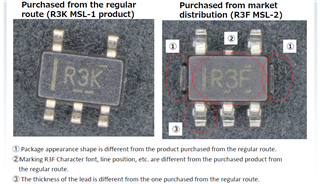

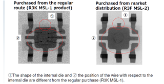

I got the following parts from the market, but please tell me if they are the correct parts. Are the radiographs of the correct parts?
Model name: LMV321DCKR
MSL level: MSL-2
Device marking: R3F
REV (2P): CA
ChipSiteOriginCode (20L) RFB
ChipSiteCountryCode (21L) USA
AssemblySiteOrigin (22L) HFTF
AssemblyCountryCode (23L) CHN

  • Katsumi-san,
    Based on the burry X-ray and top side symbol, these part are consistent with TI product. That just means I have no evidence to prove not TI.
    In many similar cases, I have asked why there was concern enough to X-ray? Is there some specific electrical application concern?
    In every previous case, I never got an answer.

    Confirmation result of TI LMV321IDCK market distribution product
  • Katsumi,
    The different die shapes are normal. It is a result of product change notice from year 2019. The smaller die is the implementation of the approved PCN.

    From the following PCN information
    TI has announced PCNs for additional assembly and manufacturing sites.
    The PCN states that the product may be changed to MSL2 with additional fab sites (FRAB) and new assemblies and test sites (HFTF).
    Manufacturing and assembly site changes that cause X-ray differences, manufacturing sites affect mold modifications, materials and designs, and AT sites affect assembly materials, processes and frame designs.

  • Katsumi,
    Here is why I say it appears to be real.
    Top symbolization appears to be correct.
    Lead frame shape appears to be correct.
    Die size size appears to be correct.
    Die rotation appears to be correct.
    Bond wire locations appears to be correct.
    I looked at the many aspects above.  It looks correct to me.
    If you remove the capsulation and provide a high resolution photo of the die, I could check that too.

  • All of this data is confidential, so I can not supply it.
