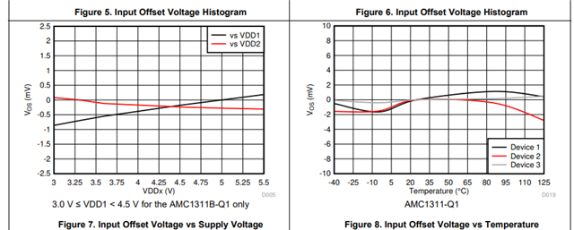

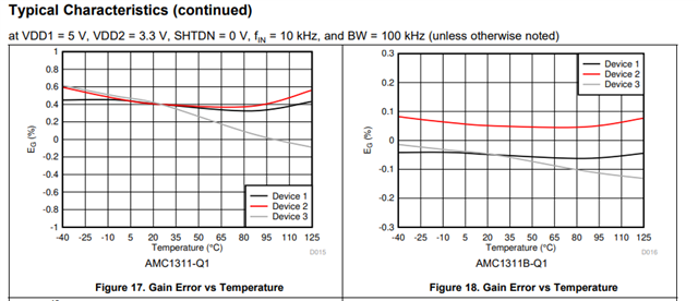

Hi team,
We found in datasheet that AMC1311-Q1 datasheet typical curve shows Device 1 2 3?  Could you please help explain how should we interpret this? Are three devices measured under the same condition at same time? Does this mean different device have different temperature coefficient? For some device the temperature coefficient is positive and for the others negative?
Scarlett
  • Hi Scarlett!
    Yes, the AMC1311 datasheet curves are from 3 different devices from three different lots, operating under the same conditions.  There are part-to-part and lot-to-lot variations so the curves are meant to supplement the min/max limits shown in the electrical characteristics table.
