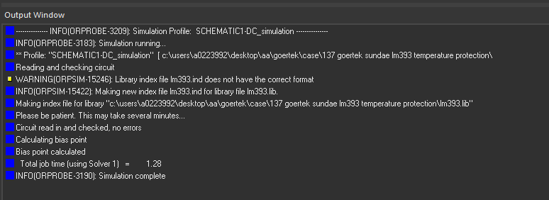

    Please find the attached zip file. I open it use PSpice for TI, it could work normal. Let me know if you get any further questions.
    There is only one warning during compile this project, however I didn't use the model from LM393 lib, I use the model from the PSpice Texas instruments lib, so I think this will not be an issue.
    For the part pins connection, I verified to remove the R10, then the comparator output is correct to 12V. So I think the pin connection is correct.

  • Hi Will,
    It looks like the delay line used internally to provide the propagation delay does not work properly in a DC point simulation. Essentially, the DC operating  point tries to resolve the first time point, where the signal has not propagated through the delay line yet.
    If you run a transient simulation of greater than 1us, you will get the proper result.
    If you must be able to do a DC simulation, you can bypass the prop delay in the model with a slight modification to the LM393.LIB file.
    In the "Prop_Delay" subcircuit, comment out the delay line and replace it with a resistor.
    Comment out (*) the T_TPD line and add the R_BYPASS line
