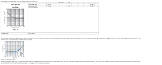

My question is, does TI have a curve or data shown the input current noise density as a function of frequency for frequencies above 10 kHz, extending up into about 1 MHz?
For some background, I pasted the following from one of the competitors that show the current noise density .

  • Hey Kenneth, I used to do that on JFET input parts like the OPA656, but but it doesn't really help you and very hard to measure. Once it becomes a significant output term, the R's values to see it have self limited on BW do to parasitic C's.
    The THS4631 is an extremely old part on a 1980's process, perhaps look at the much newer OPA810
