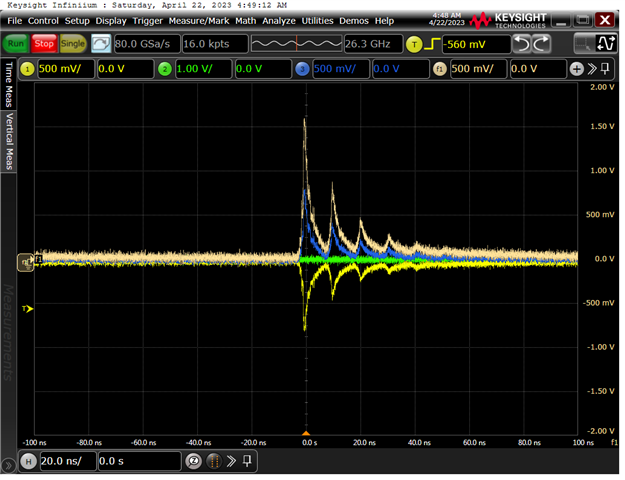

We're working on utilizing the LMH5401 as a wideband single-ended to differential converter for interfacing the output of a photodiode (Thorlabs DET08CFC) to an ADC. the photodiode stated that matching the termination to 50 ohms will maximize performance at high speeds. I modified the eval board to use the resistor values specified for single ended input with 2V/V gain, with RG1 = 90.9R, RT = 76.8R, RG2 = 121R, RF = 175R. I am routing each of the outputs into separate inputs in a high speed oscilloscope, with 50 ohm internal termination, and using a math function to observe the differential output. It would appear that there are reflections along some path in the signal chain, scope pictures attached. is there something I am missing for properly modifying the external resistor values?
