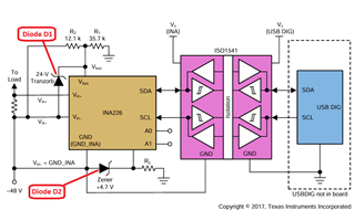

  • I found application note TI Designs: TI TIDU361A
    In the attached diagram taken from TI TIDU361A. The Vin- of INA is connected to the negative power supply. In my case the negative power supply is -5 V. The same Vin- is also connected to GND_INA in the diagram, which is the ground pin of the INA device. This look like the GND pin of INA is connected to negative power supply which is -5 V.
    I have marked two circles in red in the attached diagram. The red circle on the top is Vbus of INA. What will be the voltage of Vbus connected to Zener diode ? The resistors R1 and R2 making voltage divider also connected to Vbus. Do we need to make Vbus positive ? What is Vbus voltage ?
    The other red circle on the bottom in the diagram. Is that "Vs" of INA ? With Zener diode (+4.7 V) and resistor Rz on the bottom, are we making Vs positive ?

  • That circuit uses the voltage divider and the 24 V Zener to ensure that the voltage at Vbus is in the valid range. (Note that the load uses a −48 V supply.) With the INA3221, Vbus is allowed to be between 0 V and 26 V (relative to the GND pin).
    Yes, that unlabelled connection is the INA226's supply. When you have proper GND and −5 V supply rails, you do not need a Zener.

    Thank you very much for your comments. I learn a lot from your comments. This help to understand the circuit diagram I posted in the original post taken from an application note in which INA226 was used as bus and shunt monitor for negative power supply -48 V.
    In my application, I have -5 V instead -48 V. The negative power supply -5 V is connected to a load. The load current is not more then 10 mA.
    The power supply pin of INA226 (or INA3221) is Vs and according to datasheet Vs has to be within 2.7 V and 5.5 V with respect to ground.
    If I connect the INA_GND to -5 V and Vs to the 0 V which is PCB_GND (the signal and power ground for positive power supply on the PCB).
    If the Vs pin is connected to 0 V (PCB_GND) and the INA_GND is connected to -5 V, then Vs is INA_GND + 5V already. Do I need to connect a diode, marked as "D2" red in the attached circuit ? Do I need Rz ?
    Regarding Vbus, if I also connect Vbus to 0 V (PCB_GND) then then Vbus is also INA_GND + 5V already. Do I need to connect a diode, marked as "D1" red in the attached circuit ? Do I need R1 and R2 ?
  • You do not need either diode.
  • Thanks Clemens for your support on this.
    John,
    Clemens is correct that for your application you will not need either diode. You will also not need the voltage divider (R1 and R2, since your VCM is within limit with respect to device GND.
