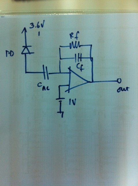

    - I still think of the alternative architecture I mentioned earlier. Connect the PD to the negative terminal of the Opamp and keep the AC coupling capacitor. In this architecture, there can be no DC current flow due to cap, but the AC current should flow nicely. Potentially this also doesn't suffer from the resistor noise in the AC coupling circuit. I am not an expert on this matter but I cannot seem to find any serious issue with this circuit, other than no return path for the DC. Can you comment?
    I attached a picture.
  • Frank;
    It is a tough tradeoff without using an optical filter. Your circuit will work but the DC biasing is not really doing anything without having a return. The photodiode is operating at  zero bias. You still suffer the gain compression by high levels of DC background current.
