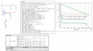

Hello.
This is Kwonjoon Lee from Samsung.
I would like to ask about OPA2992 PSpice Model.
(Situation)
1. Currently, I am using LTspice for simulation of OPA2992.
2. The simple analog buffer is designed with the unity-gain feedback configuration (OUT is connected to IN-).
3. VCC = 6V, VEE = 0V, IN+ = 4.3V
4. In a DC operating point simulation of LTspice, voltage of OUT pin of the analog buffer is 3V.
(Questions)
1. I would like to ask if OPA2992 PSpice Model is an accurate model.
2. If there is a problem in OPA2992 PSpice Model, could you provide an accurate model?
Kwonjoon Lee
  • Hi Kwonjoon,
    Yes, the OPA2992 PSpice model should work in LTSpice simulator. If you are not sure, please import the attached *.txt file in the tool and I do not see issues.

  • Hello Kwonjoon,
    You wanted the LTSpice model and I provide it. I can not support you via LTSpice tool due to license agreement.
    Multiple Aol related simulations are provided, but you claimed that our Spice model is not accurate. Aol behavior model through simulation is only good within ±30% of the published GBWP.
    To simulate the op amp's Aol, the Aol as a function of supply voltage is not modeled. Most companies do not model the Aol behavior vs. supply voltages.
    I asked what you are trying to do, there is no response. I do not use V+ and V- convention, though some of our datasheet are presented this way, but at least the datasheet has a picture associated with the notation. Without a context, the convention is very unclear.
    The OPA2992's modeled features are listed at the beginning of the *.lib or *.txt model.
    OPA2992 Aol and Phase Margin 03762025.TSC
    Here is V+ = 1.35Vdc and V- = -1.35Vdc Aol simulation.  As you can see, it makes no differences. So the Spice model is fine, if you know what you want.
    Have a Nice Day!
