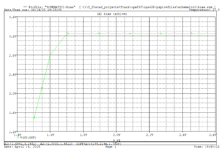

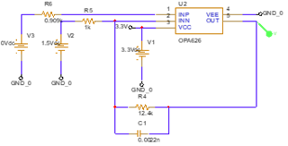

I perform a simulation to check the output of OPA2626 when the input voltage is out of range. But the result is not what I expected.
Here I use 3.3V to supply OPA2626, so VCM should be less than 3.3-1.15 = 2.15V. The transfer ratio is  I perform a DC sweep of V3 from 1.5V to 2.6V.
And the curve start to turn at 1.6V, at I expect it to change at (3.3-1.5)/13.4+1.5 = 1.63V. Could you tell me why?
