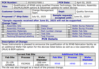

After reviewing the PCN#20250327000.1,  have some questions about parameters that have changed.
After reviewing the modification summary, all the parameters seems to be the same beetween datasheet revision E (2013) and datasheet revision F (2025) for the LMC6041IMX.
Except 2 parameters : Input current noise and THD.
  • Changed input current noise from 0.2fA/√Hz to 12.5fA/√Hz
  • Changed total harmonic distortion from 0.01% to 1%
My question is :
Is there a real regression on these 2 parametrers ? or the way to test/qualify have changed ? (seems to be the case for the THD but not clear at all for the input current noise).
Many thanks for your help.

  • Hi Nicolas,
    This is the new PCN for the LMC6041 series.
    https://mm.digikey.com/Volume0/opasdata/d220001/medias/docus/6745/PCN20250327000.1.pdf
    The changes stated in the datasheet are confirmed on a lab bench test per our standard test configuration for op amp. It reflects the actual changes in the part. So is the %THD figure. For unexpected reasons, these figures are worst than the previous FAB.
    If the specification does not meet your requirements, you may have to consider alternative. Similar replacement may be TLV9101 or others.

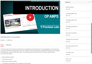

    The goal for me is to understand the differences with the new chip, and evaluat if they are minor or not.
    Please see our Precision Labs op amp video series in Input offset, input bias current and Noise topics.
    https://www.ti.com/video/series/precision-labs/ti-precision-labs-op-amps.html
