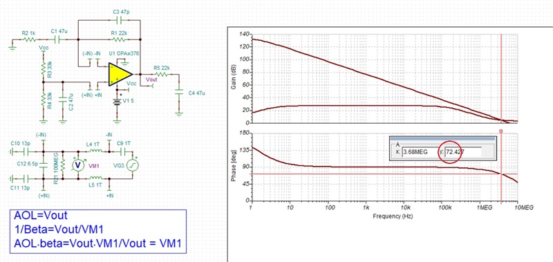

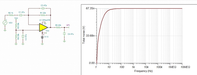

Why when I turn the pot all the way to ground (0% setting) I have interference noise? The noise vanishes as soon as I advance the pot about 2-5%. What am I missing here?

Hello Rigas, welcome to thew TI E2E forums.
Can you share the TI_TINA file and the noise result?
The total output noise of the configuration is very small as it is filtered out by LP output filter - see below.
The circuit is also pretty stable with over 72 degrees phase margin - see below.
Thus, one of the reason for what you see may be the fact that I do not see any supply bypass caps - see below.
If you continue having problems, please show us the scope picture of your "interference noise" so we may be better able to assist you.
