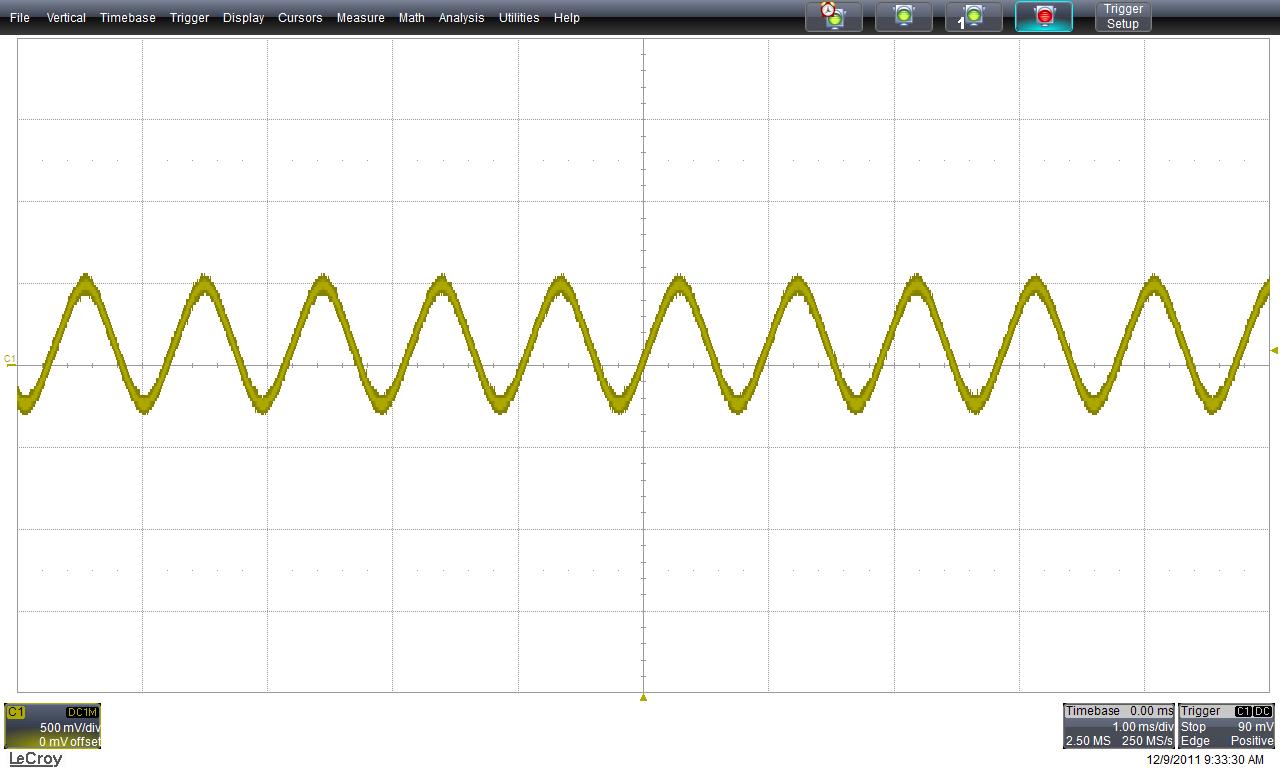

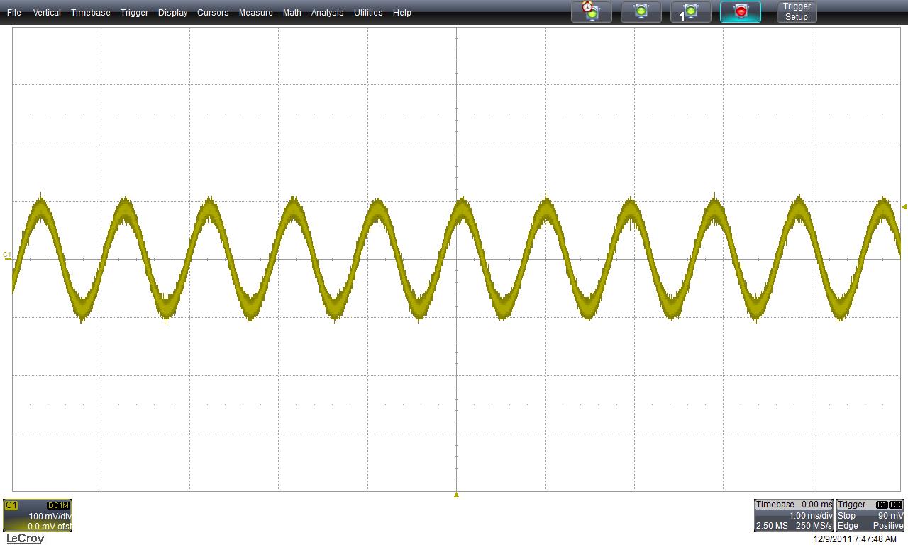

We an issue with our VCA820 circuit not matching the results we see in TINA
We implemented an AGC loop based on the circuit shown Fig 83 (page 22) of the VCA820 datasheet with some minor changes differences, we simulated the circuit in TINA, but we are not seeing what we expected on the board.
Included with this post are several captures showing the problem as well as the simulation model.

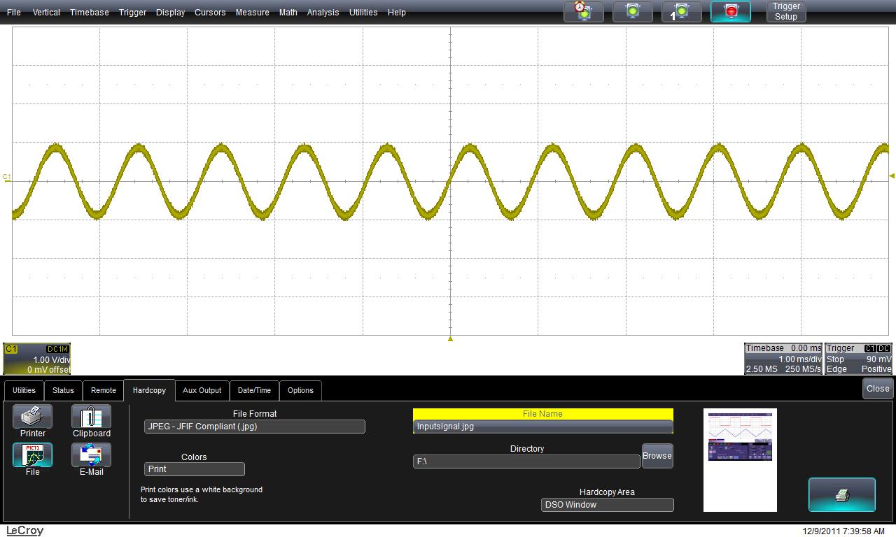

The input to the circuit is a 2V pk-pk signal, 0 offset (shown on inputsignal.jpg)
The input to the VCA820 is a 200mV pk-pk signal, o offset (shown on vca820pin.jpg)
Output of VCA820
The output of the circuit is a 3V pk-pk signal with some offset (shown on opa695pin6.jpg)
The expected output was a 5V pk-pk signal with little to no offset.

  • There was a problem in the loop adjusting the gain control voltage of the VCA820.  Once this is resolved and the integrator bandiwdth is increased to pass the signal of interest then the circuit is working properly.  See attached simulation file.

    The main error in the circuit from the datasheet is that the input bias current of the OPA820 will drive the integrator to the rail, so the circuit will never work as an AGC circuit.
    The new circuit I suggested corrects the functionality.  Now the VCA820 gain is always reduced from a maximum gain, so once the maximum gain is set in the forward path, the only possible action is to reduce it.  This circuit is very quick at reducing the gain as this is set by the integrator circuit.  It is possible to slow this down by increasing the feedback capacitor.
