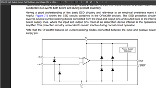

Hi team,

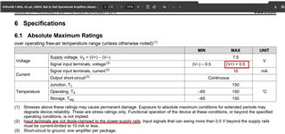

we know that OPA4310's Input pins can swing beyond (V+) as long as they stay with in 6.0 V, there has No diode structure from input pins to (V+). The datasheet says OPAx310 features no current-steering diodes connected between the input and positive power supply pin. are they snapback ESD? Or it's just steering diode for TI's amplifier products (I see some comparator products say there has snapback ESD)? thanks.
In addition, OPA4348 doesn't have diode structure from input pins to (V+) neither, while the datasheet spec shows the max Common-mode voltage at input is (V+) + 0.5V. if there has no diode-clamp to V+, why the max common-mode voltage at input is not a fixed value (such as 6V in OPA4310)?

    Thanks for your post.  I agree with your statement about OPA4310.  It has fail safe inputs that are protected by a snapback ESD protection diodes as you have stated.  However, I am not following you when you say that the OPA4348 also has fail safe inputs.  I don't believe that is the case and thus, the abs max table that you shared is correct.  The inputs are limited to V+ and do not have an absolute voltage input range.

    The OPAx348 does have fail safe inputs, there is a task open to fix the data sheet.
    The ESD cells on these may be Zener action or snap back. Always assume snap back so never connect low impedance sources to inputs directly. Use some series resistance in case an ESD/EOS event does snap back.
