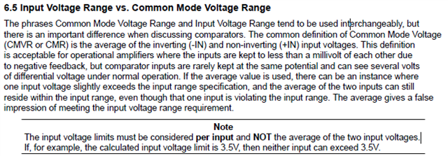

Hello Seijiro,
Your understanding is correct.
"VCM" means "Voltage Common Mode". This is more associated with op-amps, but it is the voltage on the input pins.
This is explained in section 6.5 of the application note: (CMVR and VCM are interchangeable).
Table 3.1 shows the behavior differences between the dies:
Remember, this behavior ONLY happens when BOTH inputs are above the input limit.
For example, the input range limit is Vcc-2V, or 3V input max on a 5V supply.
If the input voltages on BOTH input pins are simultaneously above 3V, the output state will be as noted in the "Both Inputs Above Input Range Output Behavior" column for that die revision.
