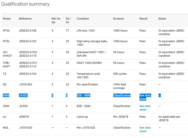

The HBM standard is quite low at ±500V, but could you disclose any test data you may have?
If disclosure is not possible, please provide the following information.
* Number of measurement samples, measurement start voltage, voltage step, and capacity of each terminal
p/n:LM211DR
