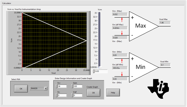

    Using the Analog Engineer's Calculator, we can see a couple things:
    1. The recommended maximum supply voltage is 36V
    2. when the common mode is at it's maximum value (>1V below V+) you have very little usable output swing.

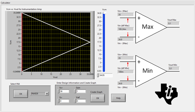

  • I was trying to see if the power supply has anything to do with the output, so I changed it to 40V, but in my design it is 36V, how can I get the gain to match with the equation.
    Chay
  • The calculator doesn't match with the Tina simulation as shown above images, which one use I use?

  • Hello Chay,
    This is partially due to the input common-mode range. I made a mistake earlier, this is a low-side current sense, not a high-side current sense.
    Because of this, your common-mode voltage is near 0V
    At max current (3A) your CM voltage will be (60mV+0V)/2 or 30mV. Setting your CM to 30mV gives you a max output voltage of 1.46 volts.

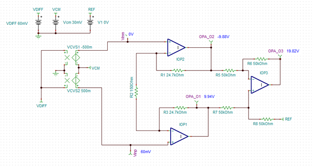

    You are running into the output swing limitation of your device. If we construct the amplifier internals out of ideal components, you can see this clearly.
    For perfect devices in this condition, to get a linear output, your IN- amplifier would have to output -9.88V. This is not possible because your V- rail is 0V, and your internal op amps cannot swing below V-.
    There are multiple ways you can fix this.
    1. Change your supply rail to be 26/-10V, this will allow for the proper internal swing from rail with your specified common-mode voltage.
    2. Increase your input common-mode. However, to increase your input CM to a sufficient voltage to get a linear output, you would need to increase your input CM to ~10V, which would mean your shunt is 10V above GND, this shift may not be acceptable.
