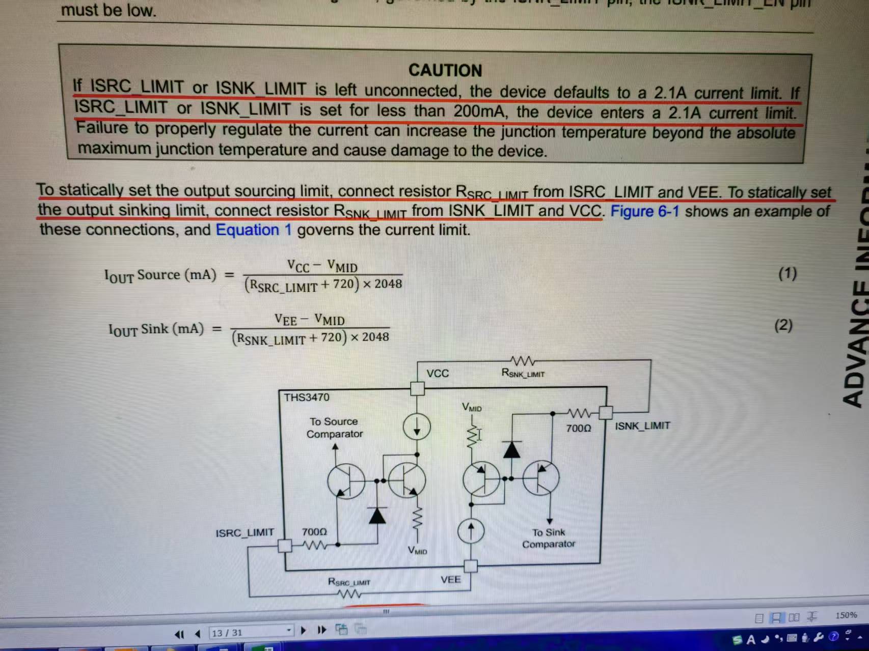

Dears,
Why the current limit equation is different datesheet vs EVM user guide.
That is a good catch, I believe the datasheet being highlighted is the older version as we updated this equation. I attached our latest datasheet with the correct equation below. It can be found in page 21. Please reference this equation for your calculations.
THS3470 60V, 1A, 70MHz, 6500V/μs, High-Speed Power Amplifier datasheet (Rev. A)
