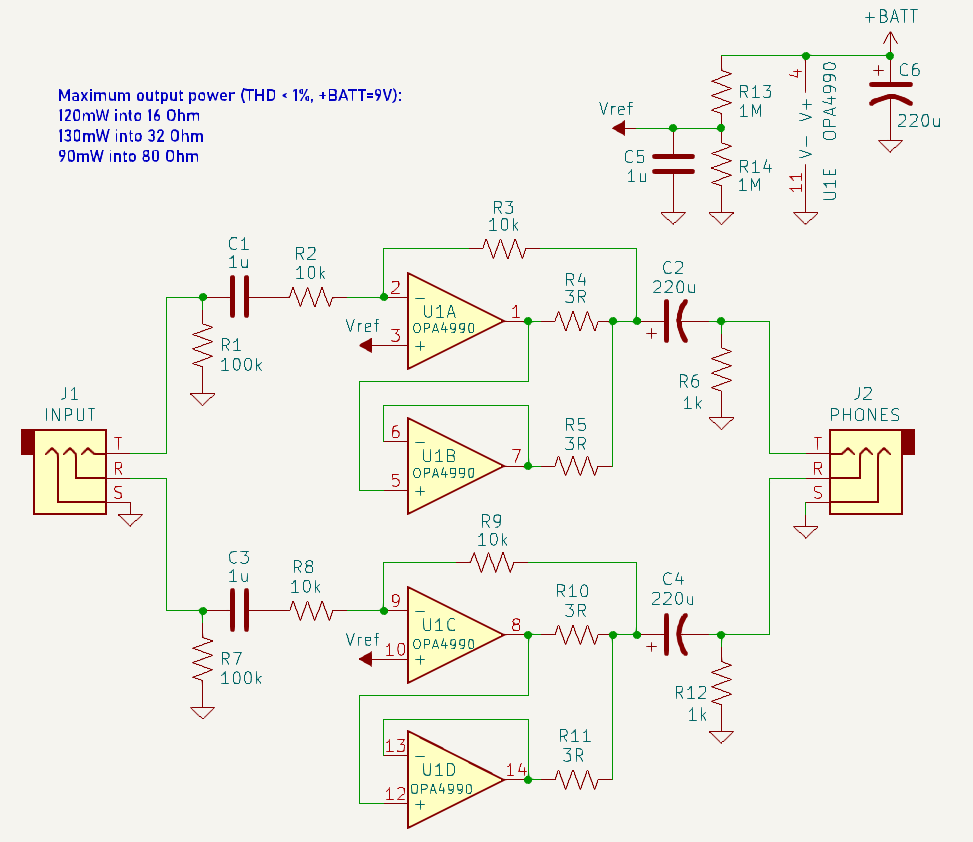

  • My supply would be 5.5V or even 6V (dropped down from a 9V battery), so output current is not an issue. The configuration is inverting, so I don't expect any crossover distortion from the input stage of the OPA310. It will all come from the output section.
    OPA2990 works down to 2.7V BTW. I tried both sections in parallel with a 9V supply, and while it delivers up to 150mW into 16 ohms and even into 32 ohms, I'm getting too much THD (crossover distortion, visible on a scope) at higher frequencies (above 1kHz or so). On the order of 2 or 3%. Very audible (and nasty sounding). I was hoping that OPA310 would have less distortion due to higher bandwidth.
  • With THD distortion devil is in the details. By inverting gain you mean -1?  What’s the output signal magnitude under 16ohm load and 5.5V supply?  What resistor values do you use for the inverting gain?
  • Yes, gain would be -1. I did not physically build an OPA310-based circuit yet because I wasn't happy with the outcome of the OPAx990, and I I don't have any OPA310 on hand, so I figured I'd ask about it first. The circuit below gets significantly more than 1% THD at several kHz with a 16ohm load and there's nothing I can do about it short of trying a different opamp. Unfortunately Tina-TI (or at least the models for OPAx990/OPA310) do not model crossover distortion, as best as I can tell.

  • My OPA2990 testing was done at a 9V supply. You might have missed this in my drawing:
    There was definitely no clipping of the top/bottom of the waveform - I kept the levels below clipping. In any case, the crossover distortion happens in the middle section of the waveform (around zero crossing) so it's actually worse at lower output power (it's a bigger percentage of the amplitude).

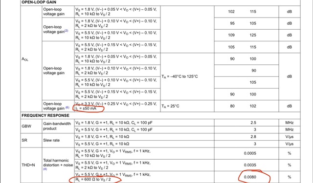

  • In the above plot was this using 9V single supply or +/-9V dual supply and what was the Rload and frequency?  Also, was Rload connected to ground (negative supply) or to mid-supply (4.5V)?  This does look like output crossover issue thus I think the load was connected to mid-supply.  On the paper OPA2310 should perform better BUT we never tested it under 60mA load so can't be sure whether it suffers from crossover distortion - only test would show.
  • "we never tested it under 60mA load so can't be sure whether it suffers from crossover distortion - only test would show."
    I'm just surprised that a part that's specifically advertised as high-output curent (150mA) doesn't have THD plots at high-output current in its datasheet. At this point I think we can close this thread, I'll have to find the answer myself on the bench.
  • There are standard THD loads (10k, 2k, 600ohm) we test for but 60mA load is not one of them.
    However, we do test for short-circuit and AOL under 50mA so we know the part is able to sink/source at least 75 mA at 5.5V supply (typical Iout is 150 mA while min is 75 mA).
