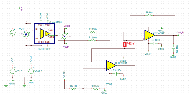

Hi Team,
our requirement is to measure 2Vac and we need o/p single ended with isolation
We did simulation with AMC1350. the o/p we wanted is , it ishould be 2.5V ref. but we are not able to get this. can you pl., support.
Hi Bosco, I think you are missing one resistor as shown below:
Best regards, Jiri
